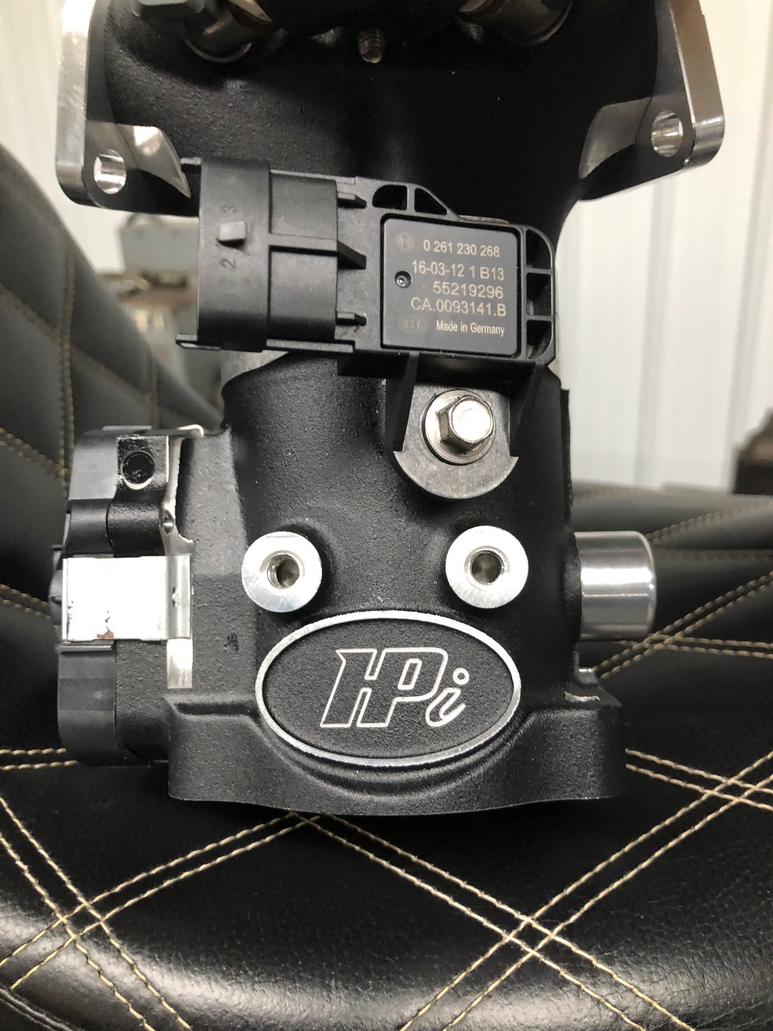

swapped out my stock intake for a big sucker II and noticed this. if I put my finger over it, the idle drops out. there isn't suppose to be a hose off this?

One would thing "exposed nipple" on a Harley forum would have more NSFW photos, lol.
On mine it has a plug on it, no hose. No idea what it's for...

hmm...anyone else? I guess I could try. but that's weird it runs poor with it closed.

ECM has compensated for the extra air coming in. It may take it a bit to relearn.

Build up a plugged vacuum hose, ride out about 5 miles, plug it off and ride back, what is the difference between the two rides. Usually a port is plugged off.
Just checked Ronnie's parts drawings and that is a "purge tube" and the drawing shows a cap on it.

I just checked and my HPi TB on the same bike doesn’t even have the tube. Could you plug the tube and reflash your tune and see if it runs correctly?

I think a hose goes from there to a charcoal canister on Cal bikes... probably should be capped.

Cap it. You can find an assortment of vacuum port caps at any automotive parts store.

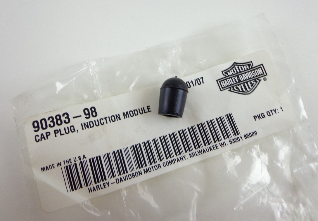

Originally Posted by WS6 Formula
Looks like you'll only need two items:
27296-12
TUBE, VALVE TO ATMOSPHERE
http://partsfinder.onlinemicrofiche....ANK%20ASSEMBLY
90383-98
CAP PLUG, INDUCTION
http://partsfinder.onlinemicrofiche....CTION%20MODULE

yeh. it drops the idle significantly...will do when the rain stops.
