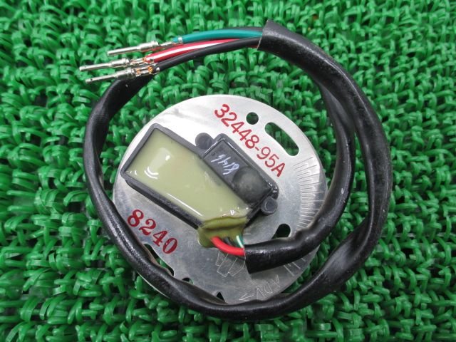

Ok evo guys I have a question, did some searching and couldn’t really find the answer, I have a 1998 fxd and my ignition cam sensor part #32448-95a went out or so I believe do to my kickstand crushing the wire, anyways is it possible to get a new cam ignition sensor part #32404-90 to work even though it say only till 1995, the price difference is 170 vs 45

HD used pretty much the same cam timing sensor till 2000, where they went to a crank trigger sensor. Try J&P or DENNIS KIRK for less costly aftermarket parts.

the part number for the year 1991-1995 is different the the part number from 1996 and on, and the also look a little different as far as the electrical portion, the price for the older one is 45 dollars and the price for the 96-? is $170, are you sure they were the same?

here is the $170 one
here is the $45
