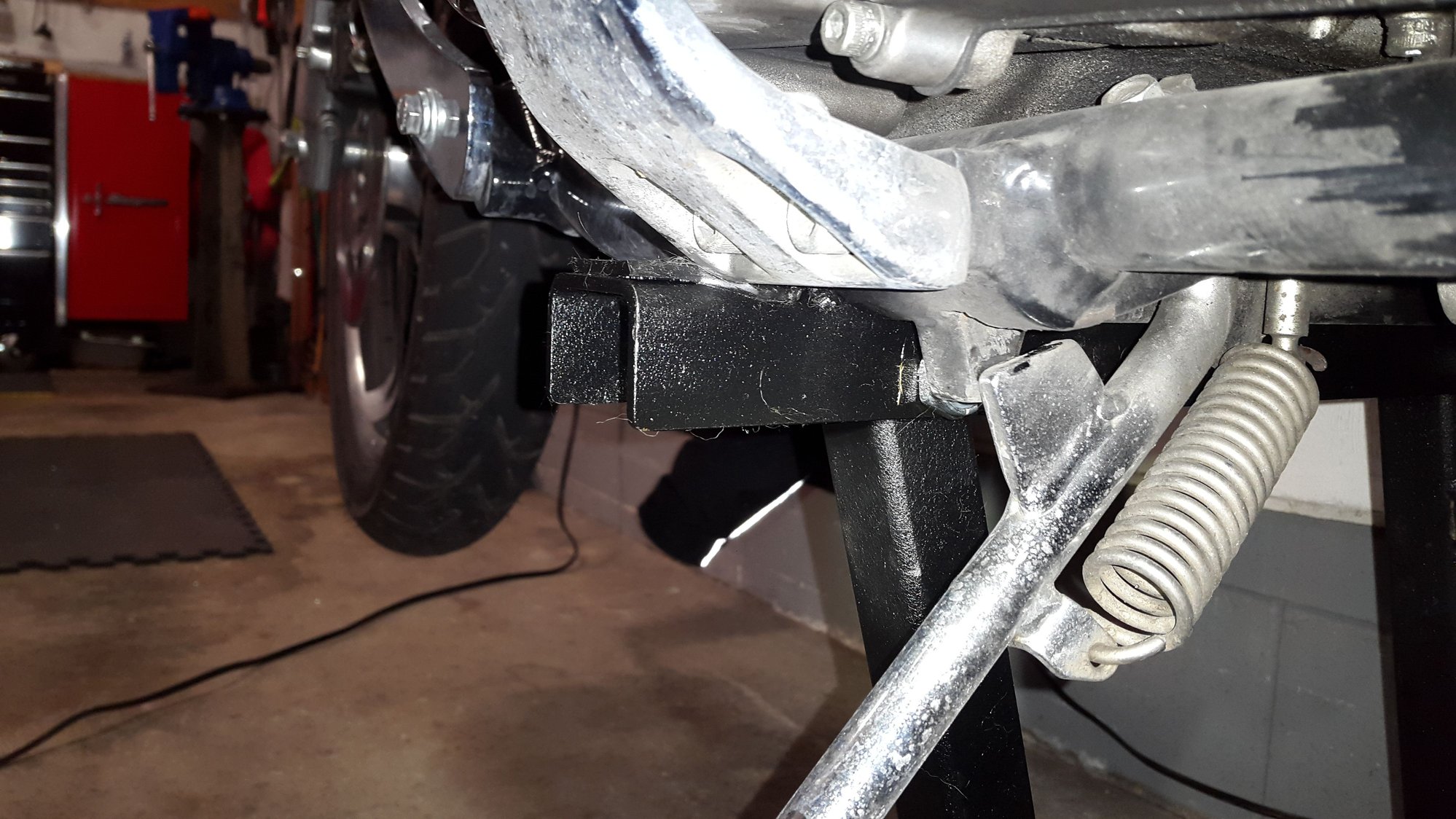

ive been running a slammer kit for over a year now with a stock kickstand. I’ve always felt a little uneasy about the lean angle when parked. Especially if it’s not a perfectly level parking spot. Anyone else dealing with this? Or am I just paranoid?

I'd grind a little off the top of the locking tab (keep the angle the same) and rattle can the metal so it doesn't rust. That will make the bike lean over more.

I bought and installed a 1" shorter jiffy stand.

That's a good option as well. But I'm tight, I'd grind the locking tab

I didn't want to grind just incase I sell the bike and put stock shocks back on. Then I can just slap the old jiffy on and good to go.
