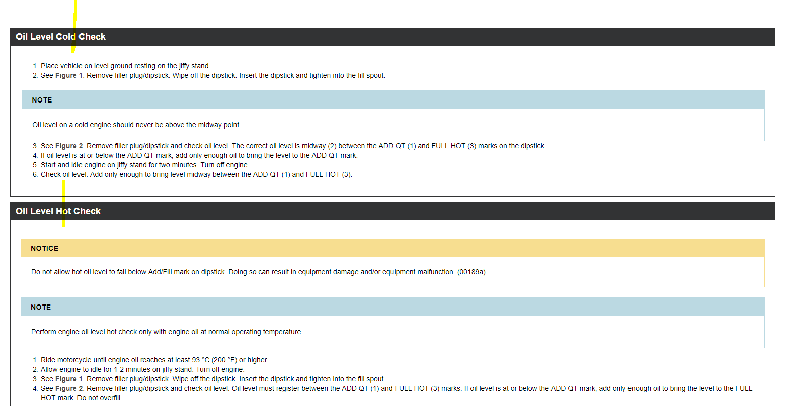

Originally Posted by dvitaso777
It says when it's cold it should not be never over medium or beetwen add and full
https://serviceinfo.harley-davidson....392292!!0!5746

So the oil level its fine then...
I gues at the service they must've added to much...
A common occurrence.
