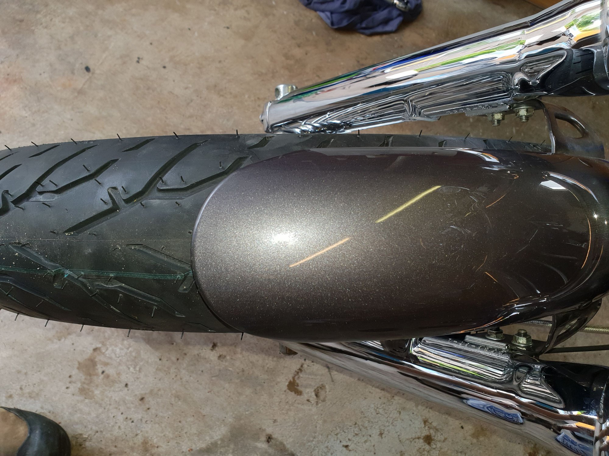

got my new DS 50 fat spoke wheel today. fitted the PND tire to the wheel and the tire sidewall is 1/8" inch off from the wheel outer rim. tire tested up to 80 psi, no leaks, but it does look strange
put the wheel onto the bike, and everything is good apart from the wheel is 1/8" over to the right hand side
any thoughts on this would sure be appreciated

As far as the tire not being centered under the fender...as a general rule, custom wheels require custom spacers...which may also require spacing the brake rotor/caliper.
As far as the bead not popping out at 80 psi...I got nothing...unless it wasn't lubed properly when it was installed.

Looks like the tire bead is not completely seated against the rim. Might need to use more lube to get the tire seated.

i agree, it just doesn't sit right.
but, i watched the tire fitter lube the rim, and inflate the tire.
it is a uniform distance all round the rim, and it seals.
think i will have to deflate and inflate again

It might be sealing but it’s not right. The tire should set flush if anything to stop **** getting in between the rim & tire, but also to seal properly....

Yea, that bead isn't seating. With the wheel off-set, is the brake rotor running cleanly in the caliper or are you getting some brake drag?
I have seen in some front wheel install instructions a note that the front wheel will be off-set on the '06 and up Wide Glide. I do know with the RC Components front wheel I just installed it's absolutely centered on my Wide Glide, but it was made to order. I believe some front wheels are designed to fit across multiple models and years. Maybe Multi can explain it to us

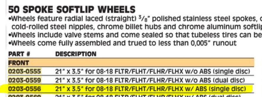

many thanks for the time for your replies, the specs are
from the HDwheels wheel sizing page
the wheel
the tire
from the hub

Pirelli doesn't seem to publish specs for their Moto tires (shame!) but the Cobra AV71 is very similar and Avon recommends a 3.5" rim for the 120/70-21. Shouldn't be stretched, so either the rim has a very large inside radius or the bead isn't seated.
