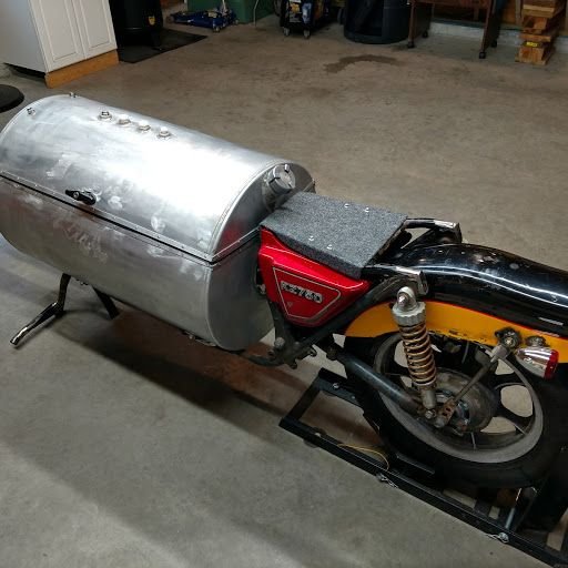

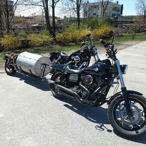

here are a few pics of my trailer that i built this winter..it hauls nice and smooth...little background, it started with a 1980 Kawasaki kz 750 roller. the main body is a tractor trailer reefer 50 gallon tank.spine is 2.5 inch square tube.hitch was built by third wheel trailers in Canada. sportster fender,. directional /tail lights are from my fat bob as is the main tail light with a lot of modding..it will be painted/powder coated this coming winter after i do some more shakedown runs. I'm no professional, but I've had a blast building this thing...

That's awesome, will look killer once it's all painted up

Man, that thing is awesome. I love creative things like that where what you're making doesn't necessarily exist already. Nice work.

Things like that are why I like going to rallies...just to see all the creative stuff people come up with. Nice job...i was half expecting to see the inside a bbq grill lol

Yeah I totally expected that to be a smoker or a grill, too.

Nice! Tell is about the fab work to create the hitch point on the bike too. I like to see how that was created.

the hitch is a sport hitch built by "third wheel trailer" in Ontario, ca.works by going through the axle. awesome work but it took almost 8 months to get one built. you won't be disappointed with the quality. just the time.. the trailer would have been on the road last year except for this problem...

Ingenious!
Will it have a separate brake?

no brake......when you go to slow or stop you know its there in heavy braking...
