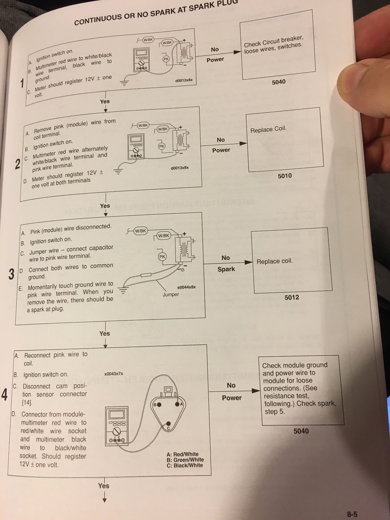

You need a service manual to see a wiring diagram. Check eBay for one or just bite the bullet and get one at a dealer. Maybe the dealer will give you a copy of the wiring diagram? Or at least give you a description of what the wires are power, ground, etc. in my manual that I have for my 1998 Dyna show 2 wires going to the coil, one is a pink that goes to the ignition module and tach. The second wire is white with a black stripe that goes to the start switch, the stop/run switch, the ignition module and a trapdoor solenoid for California models only. Here are some quick pictures of the troubleshooting procedures.

Just remember those pictures are for a EVO engine and your TwinCam may be different!

Yes my coil looks different. It has a cable that plugs into it which has 4 pins in it.
