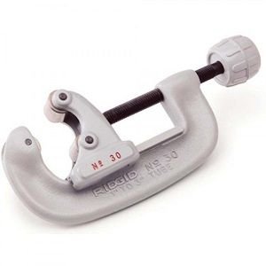

Depending how much narrower you want them, you may be able to do some trimming. I've taken off as much as an inch from each side of some bars in the past, with a pipe cutter smilar to this:
You just have to be careful that you aren't pushing controls/clamps into the bend, and be mindful of how you're routing wiring.
