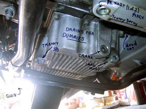

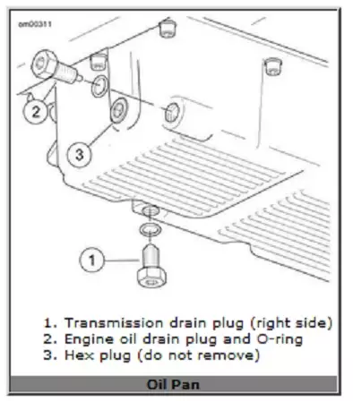

Hey guys... I've been reading a lot about types of oil, and usage to change, etc... But there's ONE thing i'm still confused on.... i have a 2005 Dyna Low rider 88ci, I put 3 quarts into the primary with a new filter, and just recently put 1 quart into my transmission (both drain plugs were near each other). BUT, where is this hidden ENGINE oil plug? And where/how do I change it? I can't seem to find anything. And when I change my primary oil, it appears to be getting run through the engine, as it is the typical BLACK color when draining and looks the same as the oil coming out of the old filter as well... Am i missing something? PS - this is belt driven, not chain...

You already drained the engine oil....the missing drain plug you are searching for is the primary...which is on the back of the primary

What you're missing is the shop manual.
The primary does not have a filter nor does it take 3 quarts. If you mean the engine oil, you only need to add about 2.5 qts.
These should help. Also, try Google.

well it appears that part of the problem is terminology being used... a good majority of searches online and including my manual call the engine oil the PRIMARY... and the actual primary well, also the primary... I believe I have figured this out.... looks like the 1 quart primary drain and fill are literally ON the primary on the left side of the bike.... and you fill by taking the primary case cover off and pouring directly onto the clutch assembly fly wheel... Thank you all for your feedback... I think i'm good to go now, minus one other suggestion from ya'll...
do you use 20w50 in all three holes?!?!? and interval times for tranny and primary? (i got the engine oil down!! haha) that's what i'm doing i believe
