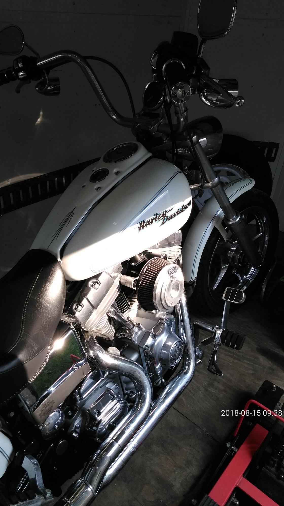

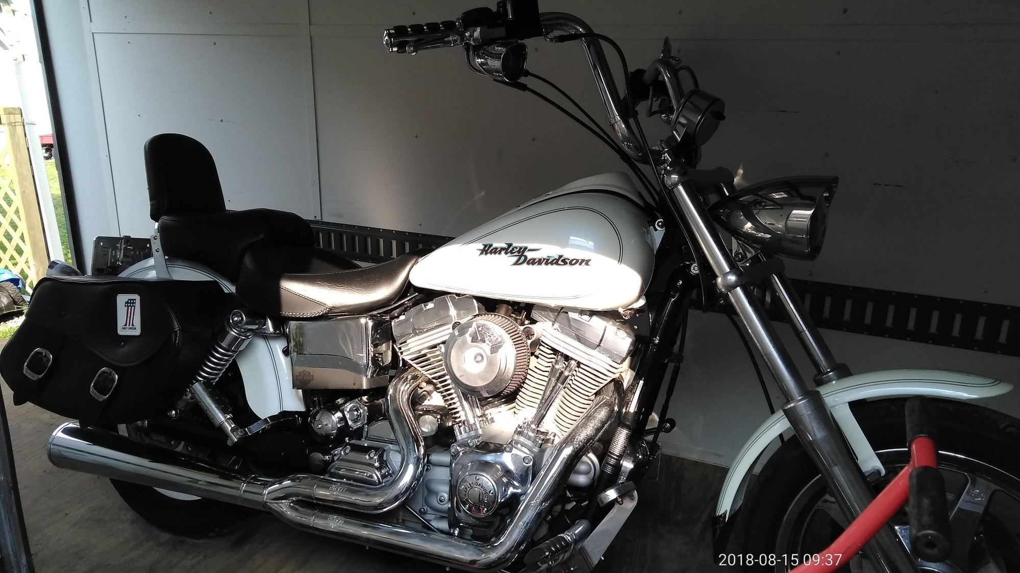

Bike's idling fine but wants to cut out when getting on throttle. Like no gas and will hear some backfire/compression out through air filter. I cleaned the throttle body and sensor. Good battery and connections. What's next? Fuel pressure test? Maybe my pump is going bad is what I'm thinking. Any other causes for that to happen?

I upgraded exhaust- V & H 2-1 pro, fuel pak also V & H, and stage 1 air filter. Still have the 88ci. I did just take it to the shop cuz of some back fire when downshifting and was hearing a big whistle of compression come out of air filter/ intake sometimes, not all the time, when I shut bike down. The shop downloaded stage 1 onto ECM and yanked fuelpak off. So I just remapped that and is back on. Test ride went good for about a mile when I lost gas throttle again.

Let me get a pic up and you can see all the rest.

I appreciate all the input from everybody that gave it. Am gonna test fuel pressure tomorrow and move on from there. Here's that pic to those dyna fans out there.
05' Dyna Super Glide Custom
