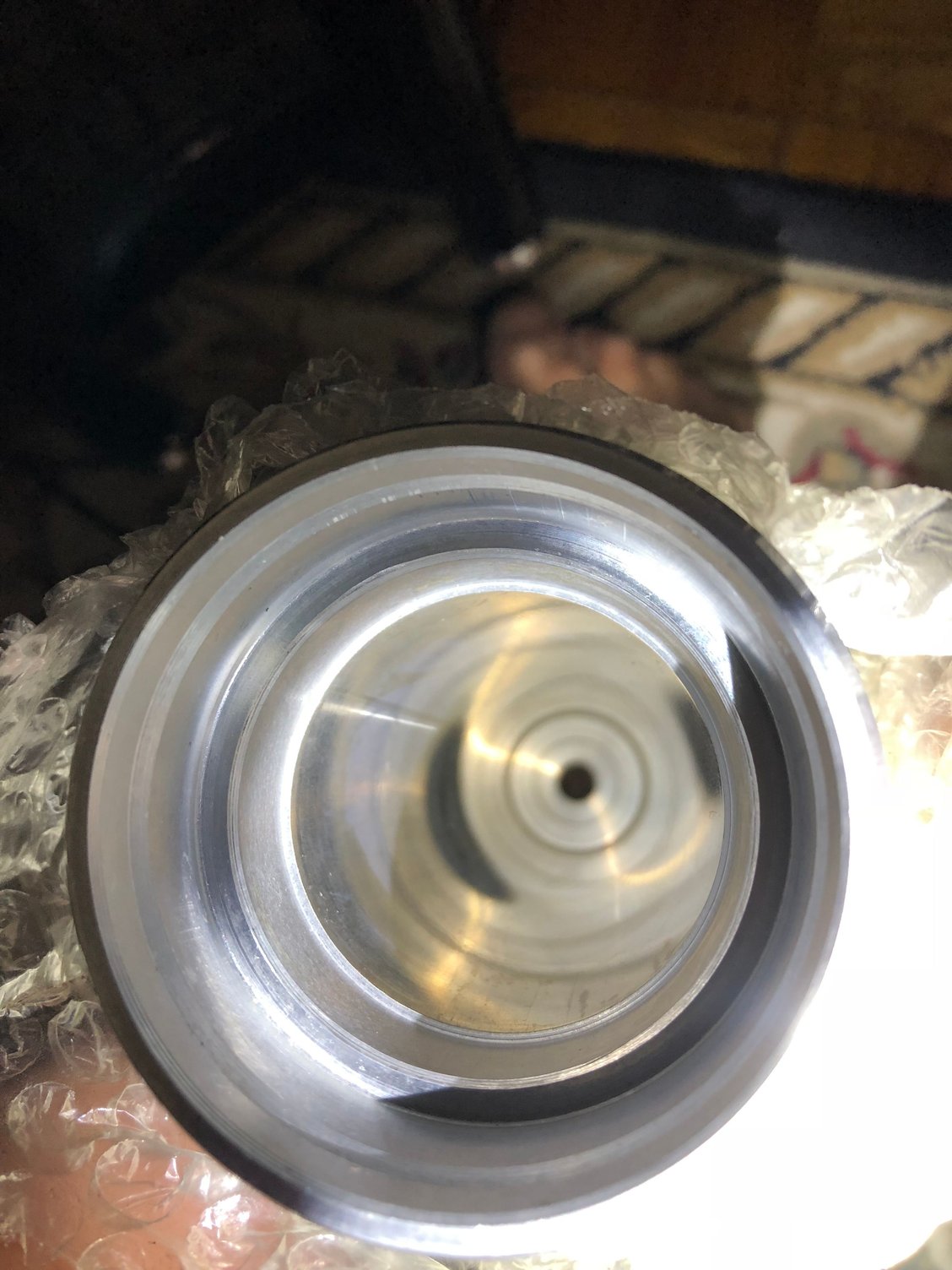

Originally Posted by cggorman
For stuff like that the dimensional tolerance is usually less critical than surface finish. I'd guess something around diameter +/- .002", circularity, axial parralelism, and surface RA of maybe 120 or less. Without an engineering document from the manufacturer it's difficult to say either way.
Not worth the risk of a rework, IMO.
The operator or order writer probably didn't know the interior needed masked/plugged. Be sure to specify all holes to be plugged in the future. Don't forget the drain plug.
You think they could say “you didn’t tell us to plug” and refuse responsibility?
Probably depends on the fine print in the quote/estimate and their familiarity with similar parts. And, of course, their customer service policies. I would hope they would step up, but ya never know.
... at least smooth out the top where the seal goes, right? What do you think?
I think it's like asking if the scratch on the mirror will buff out
Yeah, I didn't think of the bearing surface. When I wrote that I was only thinking of the seal surface.

Just spoke to Bill at Pauls Chrome. As I expected, he said "we do hundreds of these a year, exactly the same way and never have a problem. When I asked why they wouldn't plug the tube he responded that they would likely float and not be able to be submerged in the solutions. I didn't accept any of that. Forget the seal area, the entire bearing surface was etched and rough. It would kill the leg bearing pretty quickly I expect. I'm not buying that they've been doing it this way all along. You can see the etching all the way down the tube, vs a new tube below it.
Screwed lower:
New lower:
Would you put that mottled slider on your bike? I don't think so...
