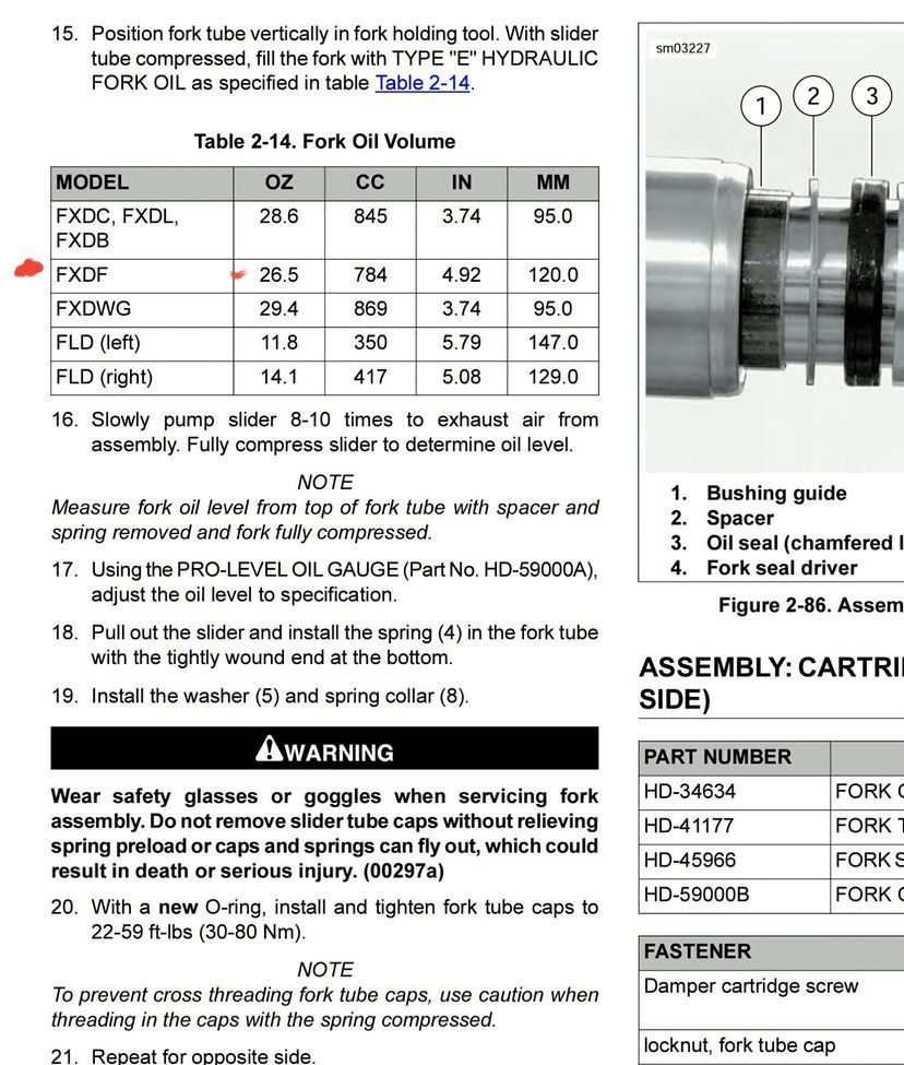

The one thing that stuck with me, is your fluid change to the forks. I believe you have the amount wrong. You will never have an accurate measurement doing it that way, you need to do it correctly. The correct way is using a measurement tool, motion pro makes one and they are cheap to buy tool wise.
Using this tool increases your ability to get both sides right, with the correct amount of fluid in each tube. Also make sure you burb the air in the tube as well. Suspension tuning takes time and precision as you can see even small changes can effect the ride and handling....
your bike should have 26.5 oz.
I can agree with you that its something that was changed, either the tire or the fluid
i have considered re-doing the fork fluid because its the cheaper route. I wonder if i can get the tool locally
i can say the fluid that i put it was along the same lines as what the manual recommends, the manual says 26.5oz and i put in right around that amount from what i remember. it was 1pt and rounghly 270ml (again measured the same amount that came out) i used my ratio rite to measure.
i did not "burp" the fluid but i let it sit for awhile before capping it. i also put the fluid in with the springs, washer, and tube in the fork. maybe that was wrong?

Ok, my guess is the fork fluid. If you have the manual...follow the procedure...chances are you have some air trapped in there.
also fill with springs out, then pump the tube up and down about 10 times. This forces air out and fluid down into the damper....
small things can can make a big difference especially when it comes to suspension
