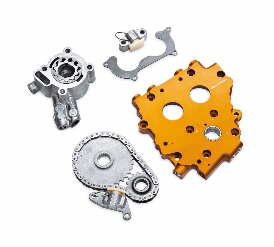

I have a 2004 Dyna Wide Glide with 34000 and I am thinking about doing the tensioner upgrade myself. I was going to purchase screaming eagle kit with the screaming eagle adjustable pushrod kit and I was wondering what else I am going to need special tools etc... I am also not sure how to properly install the bearings for the cams into the new screaming eagle plate. I was wanting to use my stock cams and I guess ill need new bearings also????

This is the kit I want to use

You will need new bearings for the camplate, and a way to press them in. Local shops dont charge much to press bearings. And while you're at it, you should replace the inner cam bearings as well. To do this properly you'll need a specialty tool like in the link below.
Harley Davidson Twin Cam Inner cam Bearing Installer+Puller/Remover Tools 99-06 Except 06 Dyna https://www.amazon.com/dp/B07B7CBPKJ/ref=cm_sw_r_cp_apa_5j8KBb2VB47WT
not trying to turn you away from the screamin eagle kit, but when I did this I went with the complete kit from Feuilng parts. Comes with bearings, loctite, assembly lube, all the seals and gaskets...its nice to have everything you need in one part number, instead of piecing everything together.
Here's the kit I used,
used http://www.feulingparts.com/products/Hydraulic%20Cam%20Chain%20Components/Oe__%20Complete%20Conversion%20Kits%2099-06/7090

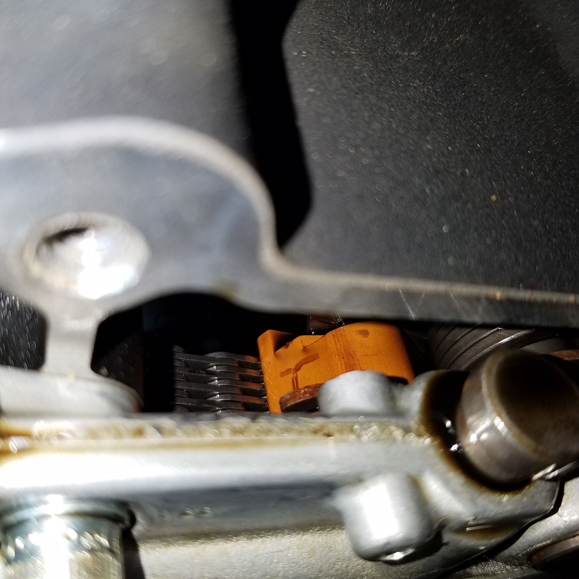

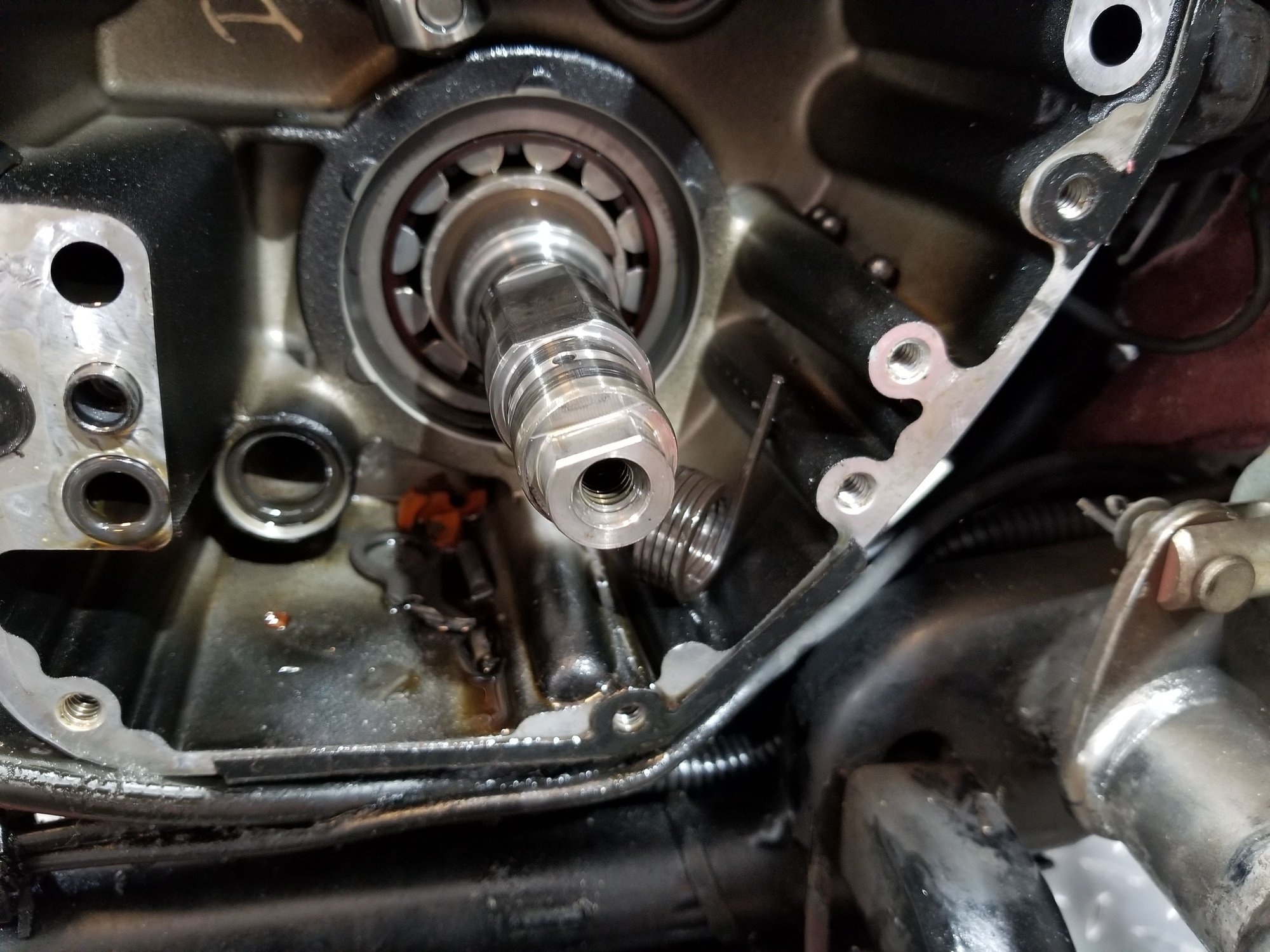

With that kind of mileage I would change them out. Here is a bike where the inner shoe came apart and the owner rode it until he heard "some noise".
