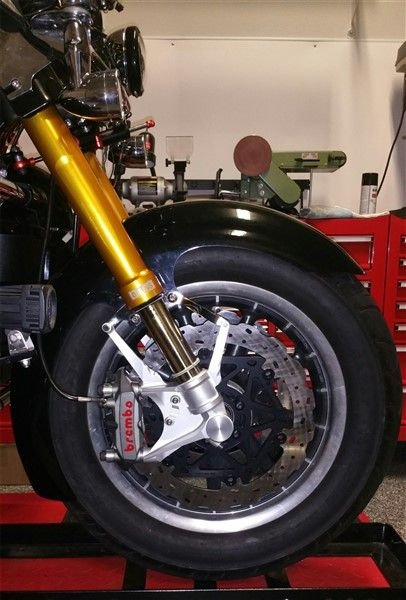

After a phone call in the VA parking lot in downtown Miami, I will let you in a little bit of wisdom. In place of buying those 7 pound OEM "Floating" HD rotors save your coin up as we are going back to work on some budget braking systems using our adapters so we can offer HD Dresser Brembos calipers and adapters along with new pads so you can run 3.1/2 # 320mm rotors on either dressers (FLT) or these V-Rod sliders. I have been using 320mm rotors for many years and there is no comparison between either the stock 11 1/2" or 300mm. When I have the time I will install and test them on my Dresser. I have the 320's on my FXDL using real Brembo's Not my first time. I did not include that picture because we have scum bags that copy my ideas and call them their own.
This is a flat slab 11 1/2" HD rotor. The "Floating" HD SS rotor weighs in at 7 pounds each.

Thanks for taking the time to chat, Howard. Send me info on the adapters when you can... I couldn’t find them on your site. Those 320 rotors also look great. Are you offering those now?
as for the VRod sliders setup, in your post about Jay’s bike, you mention “machining” the inside. What does that entail? I’m currently running race tech’s front kit with gold emulator. Thanks.
