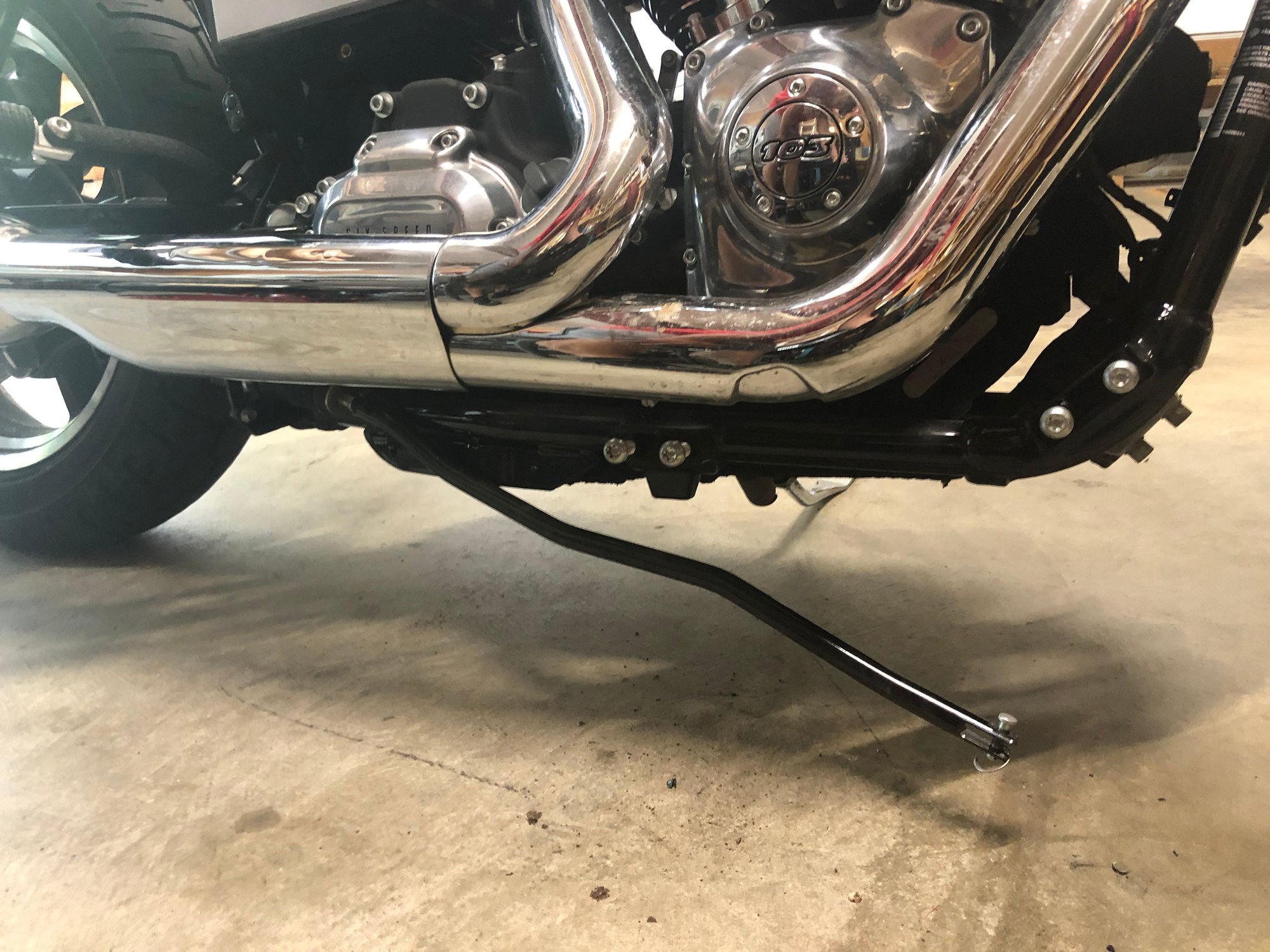

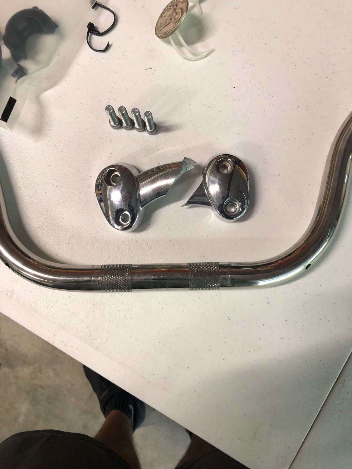

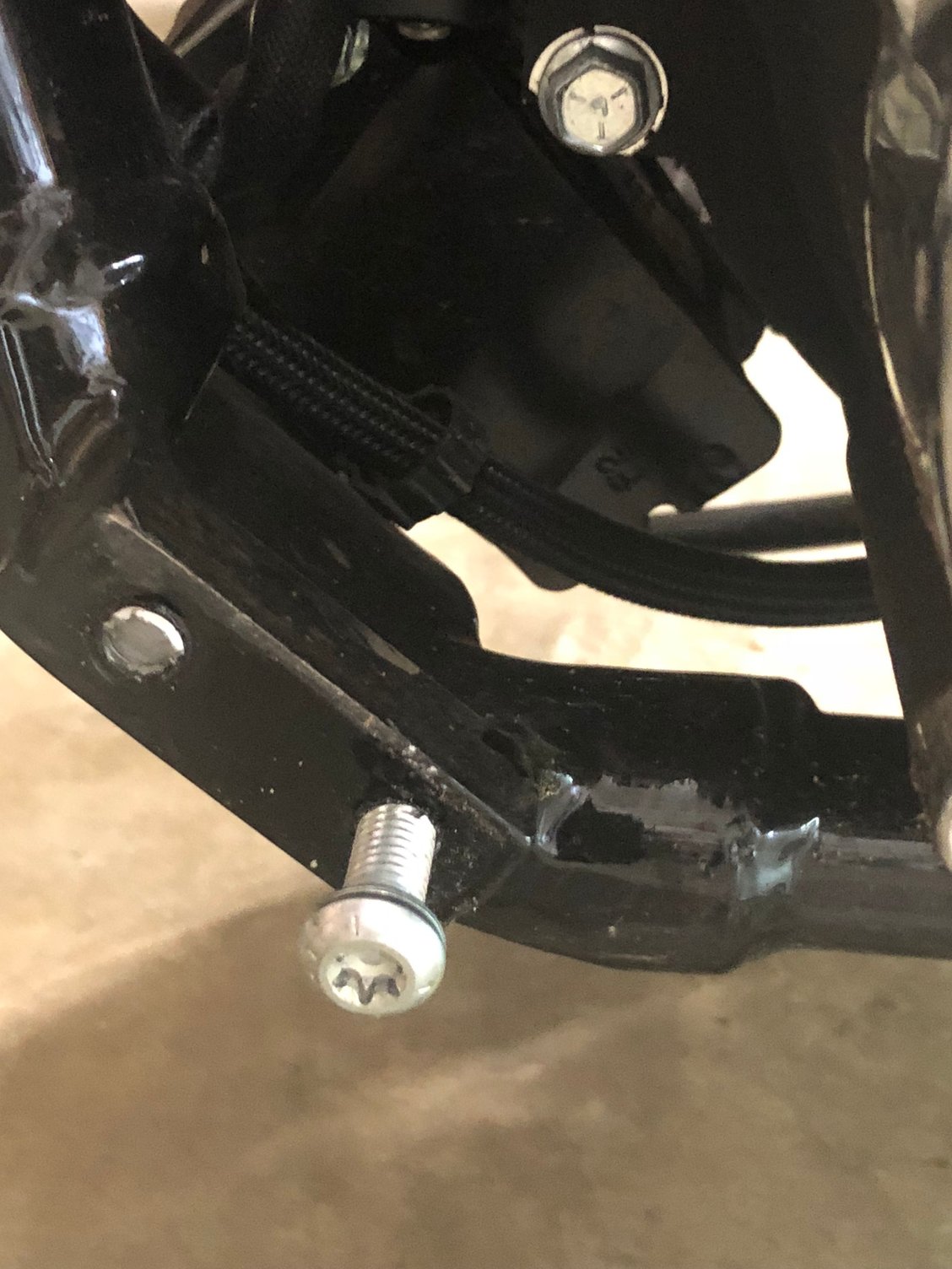

Further inspection of this disaster, and I’m thinking the frame just might be toast.
It hit hard enough the brake the handlebar clamp and I think it may have pushed the left side frame tube upward. The fwd support of the left hand floorboard was bent up and had sheared the bolt.
The transmission pan seems to stick down past the frame tube underneath. I went to jack it and noticed the jack supports would contact the pan before the frame.
