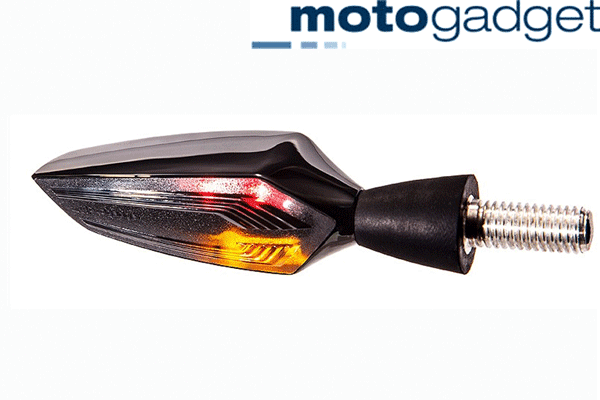

For those interested in the Rhombus or similar, an alternative might be the Motogadget M-Blaze Edge. It's a true 4 wire unit that would make installation as S/T/T easier than most.
I have used (and wrecked, and retired) the M-Blaze Disc bar-end light as well as many of their other product and their quality is second-to-none. Same with Kellermans.

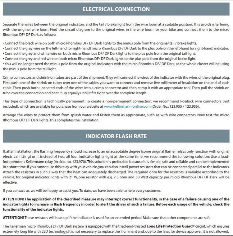

I just looked at the Kellermann Rhombus install instructions... They also seem to be a true 4-wire design. Decisions...

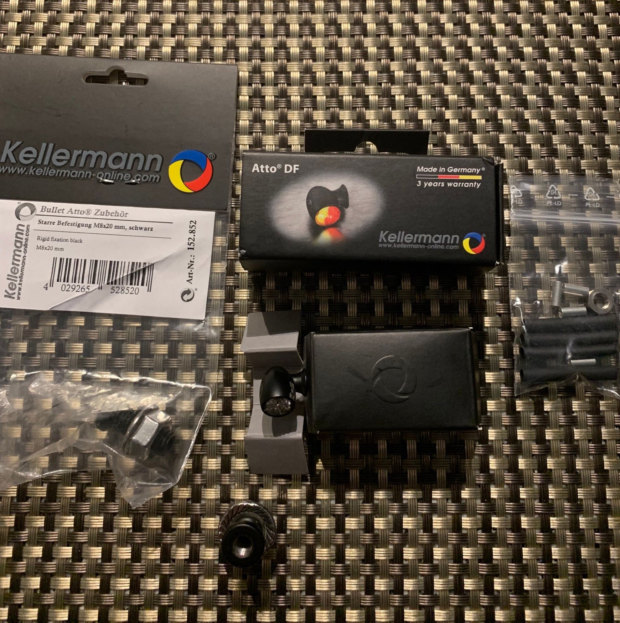

So these damn cool little things came in the other day. I’ll be putting em on in the springtime and the tablet next to the light is an Ibuprofen. Kwazy Germans! Lol
