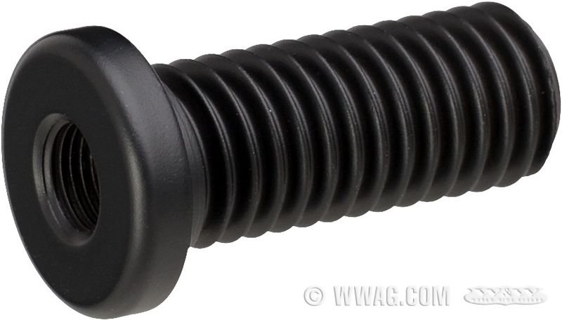

Going to be replacing my Kellerman 1000’s for the Attos also from Kellerman. 1000’s have been great but prone to being hit by my leg getting on/off the bike. If/when you place your order,make sure you get the correct adapter for your strut.
