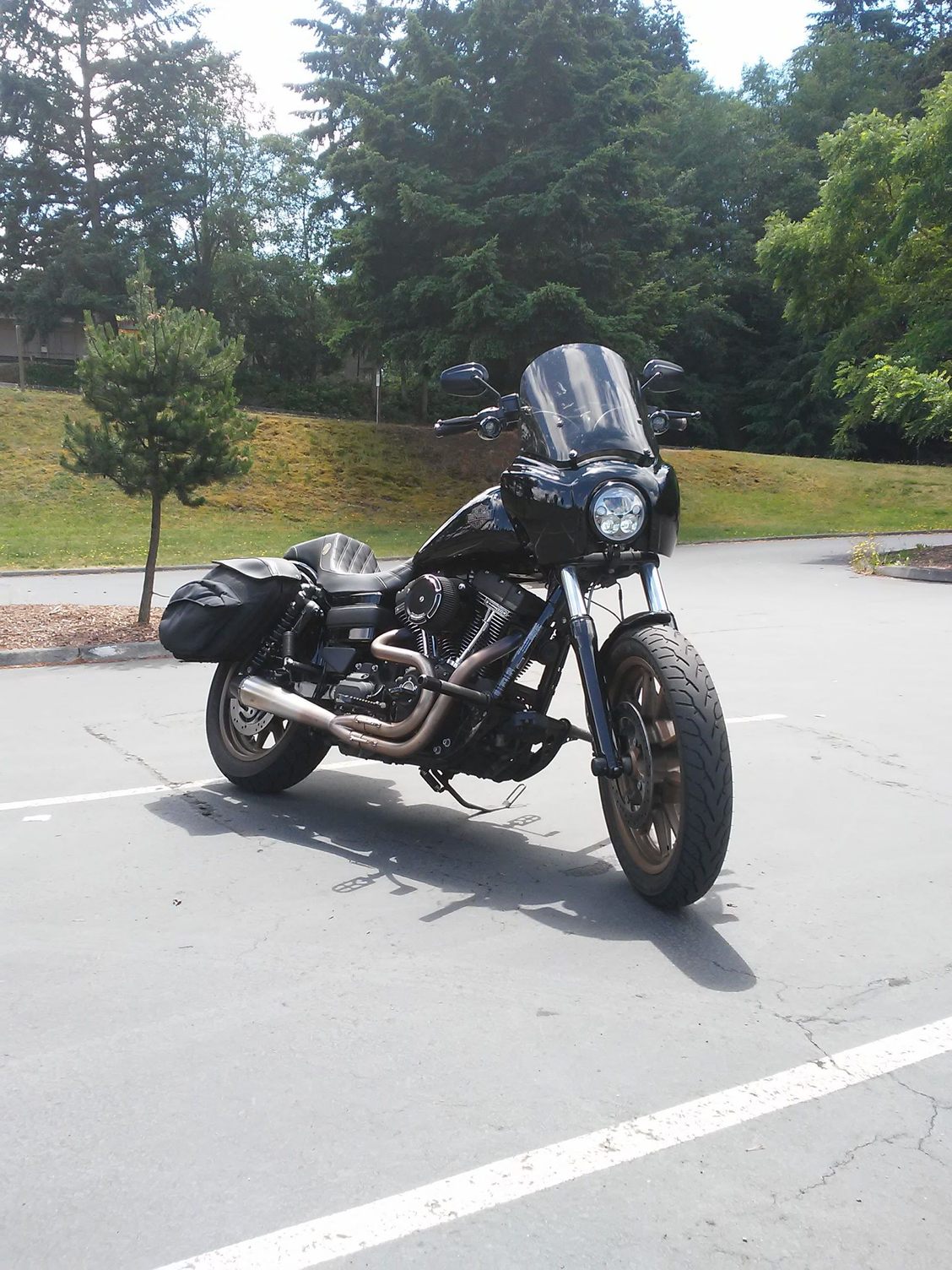

Hey Guys, looking for a little input here on the low rider s. I've got a '17 with about 23k miles on it and I'm taking it to the dealer this week because it has very noticeable noise that seems to be coming from the valve train. Sounds like like maybe rockers, valve springs, or something else in the heads but it's hard to tell by just listening to it. 1800 miles ago I took the bike in because it had developed a noisy clicking sound while on a road trip, and the dealer ended up replacing the cams, cam chain, follower, lifters, push rods, and related parts at the bottom end. I feel like this is a lot of **** to have go wrong on a bike this new and I'm wondering if other FXDLS owners are seeing similar reliability issues. I love the bike, but I'm worried that it might be spending a lot more time in the shop if I keep riding it.
