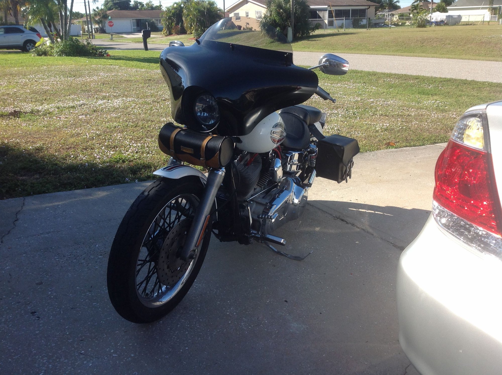

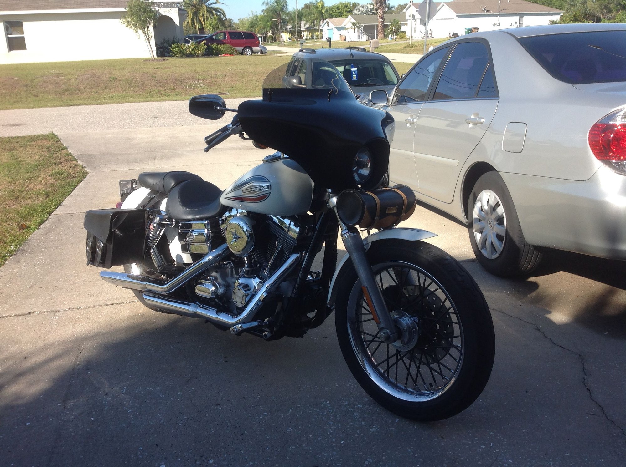

Just purchased a Memphis Shades Batwing for my 2006 FXDI35 Super Glide. Installed it about a few days ago. Didn't get a wind shield yet because needed to get the wing on first to measure for the shield. Pretty sure the 6.5" recurve shield will work for me. Soon as the shield come in I'll add pic's. So far even without a shield I notice the diff. With no shield I'm getting buffeting at around 50 or so. With the addition of the shield I should be good to go, I'll let you know.

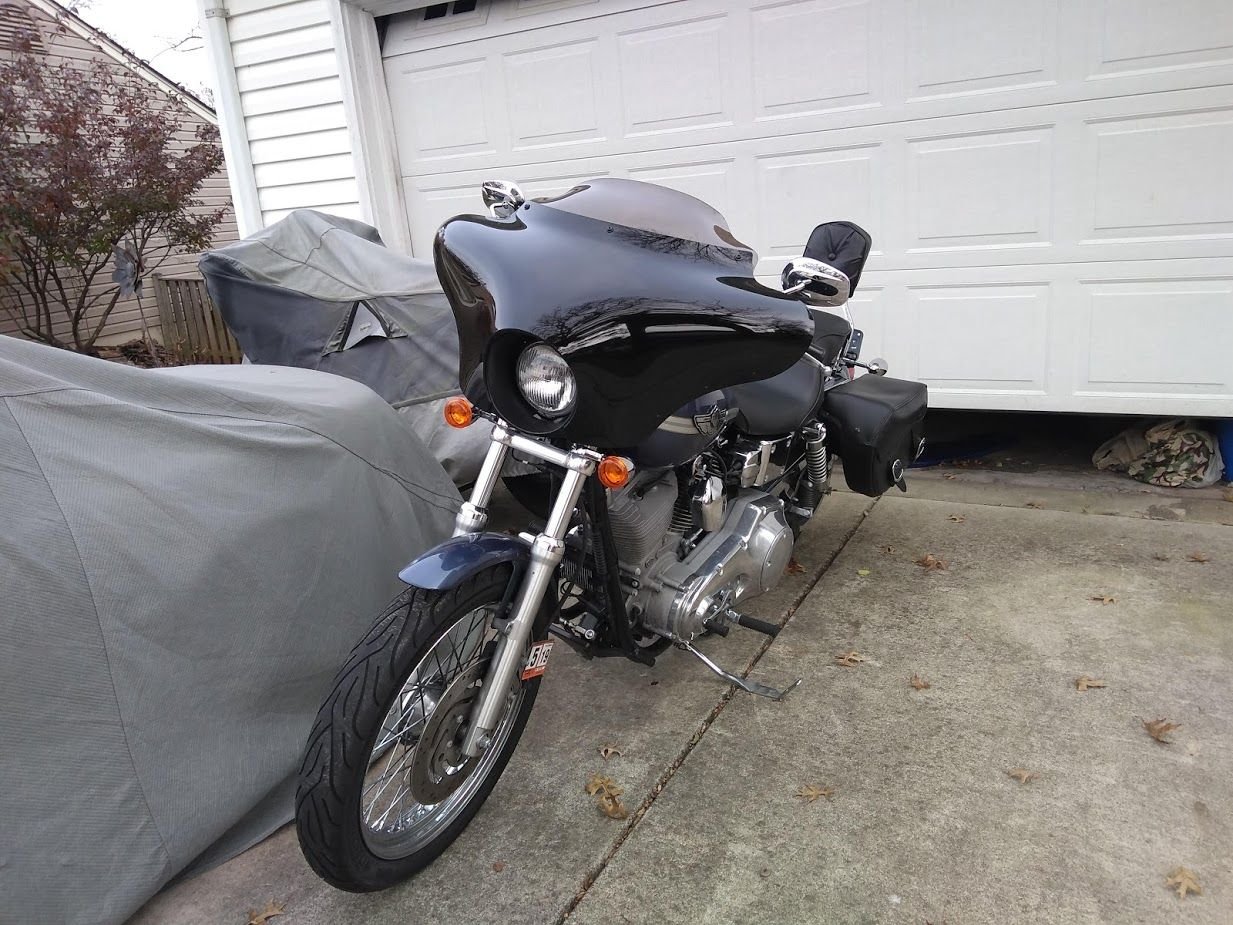

Second vote for the Memphis Shades batwing fairing, It's way too pricey by the time you get done with buying all the parts for it, but it fits perfectly and installs in maybe 15 minutes and works great.
You're kind of limited by two things. First, the Superglide speedo will interfere with any fairing that has a radio. You can relocate the speedo using a speedo mount from a later model Sportster Custom which puts the speedo behind the handlebar instead of in front. Not sure it looks that great, but definitely not bad. I measured the speedo mount from my wife's 2007 Sporty and it looks like a pretty easy bolt up. The second is the little 5-3/4" headlight. Most of the batwing fairings have a pretty big opening for the headlight and it looks silly on the small SuperG headlight.
I bought one of those fiberglass batwing fairings for $100 off of ebay (also on Amazon). Very nice fiberglass layup. Bolts don't line up exactly, so it needs some tweaking. Mentioned the headlight looking dwarfed inside the opening, plus it ends up very recessed by the fairing. Hardest thing was devising decent looking brackets to mount it. Not that hard, but only so much time for projects. Once I bought the Memphis Shades brackets, it looks like those would have been very easy to adapt.
What I like about the Memphis Shades batwing: Perfect fit and no hassles. Kicks the wind up off my chest, but doesn't cause buffeting on my helmet. Decent protection over my hands (which the little cafe fairings do not).
What I don't like: Too expensive. Shakes at idle, but pretty good past the high-vibes area. Single speedo pod looks kind of goofy behind it (fixing that by adding a tach). Can't put a bag behind the windscreen.

One more tip... I bought a 6" tall Harley batwing aftermarket windshield off amazon for $25. Took a little cutting on the bottom to make it fit right, but not too much work to save $75 over MS
Amazon Amazon
That's the shield shown installed in my previous post. I got lazy and didn't trim the outside corners where it meets the fairing. Do that and it will look perfect. Has a nice molded shape to it too.

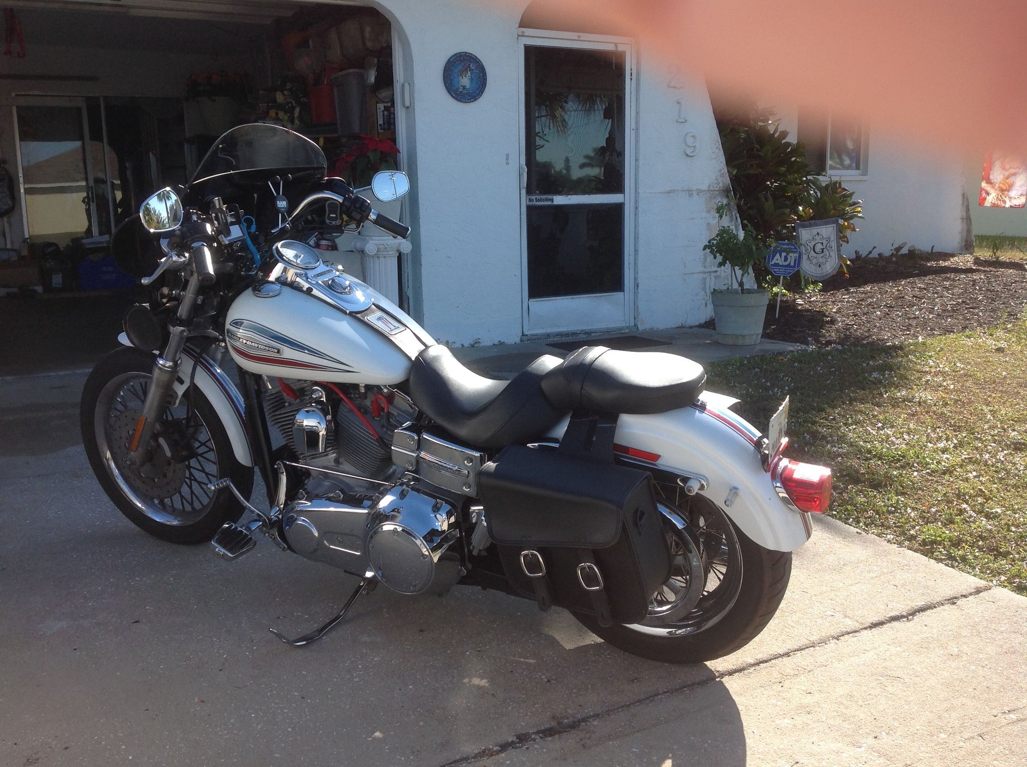

Just got the windshield in today.
