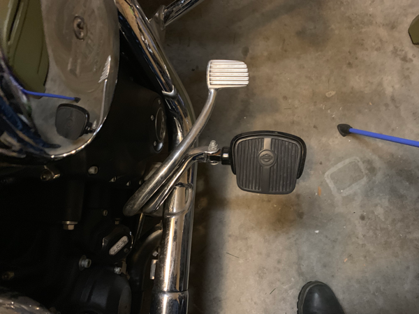

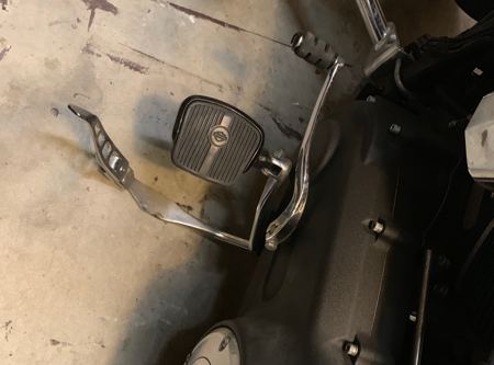

2017 Street Bob. I have a 30" inseam. I felt cramped.
I had the further-forward and the Mini Floorboard Kit Large kits installed.
The further-forward kit is awesome, the Floorboard Kit Large lets me move my feet fore/aft without any issues.
OMG what a difference it has made for me!!!
https://www.harley-davidson.com/stor...id-control-kit
https://www.harley-davidson.com/stor...07-50500124--1
