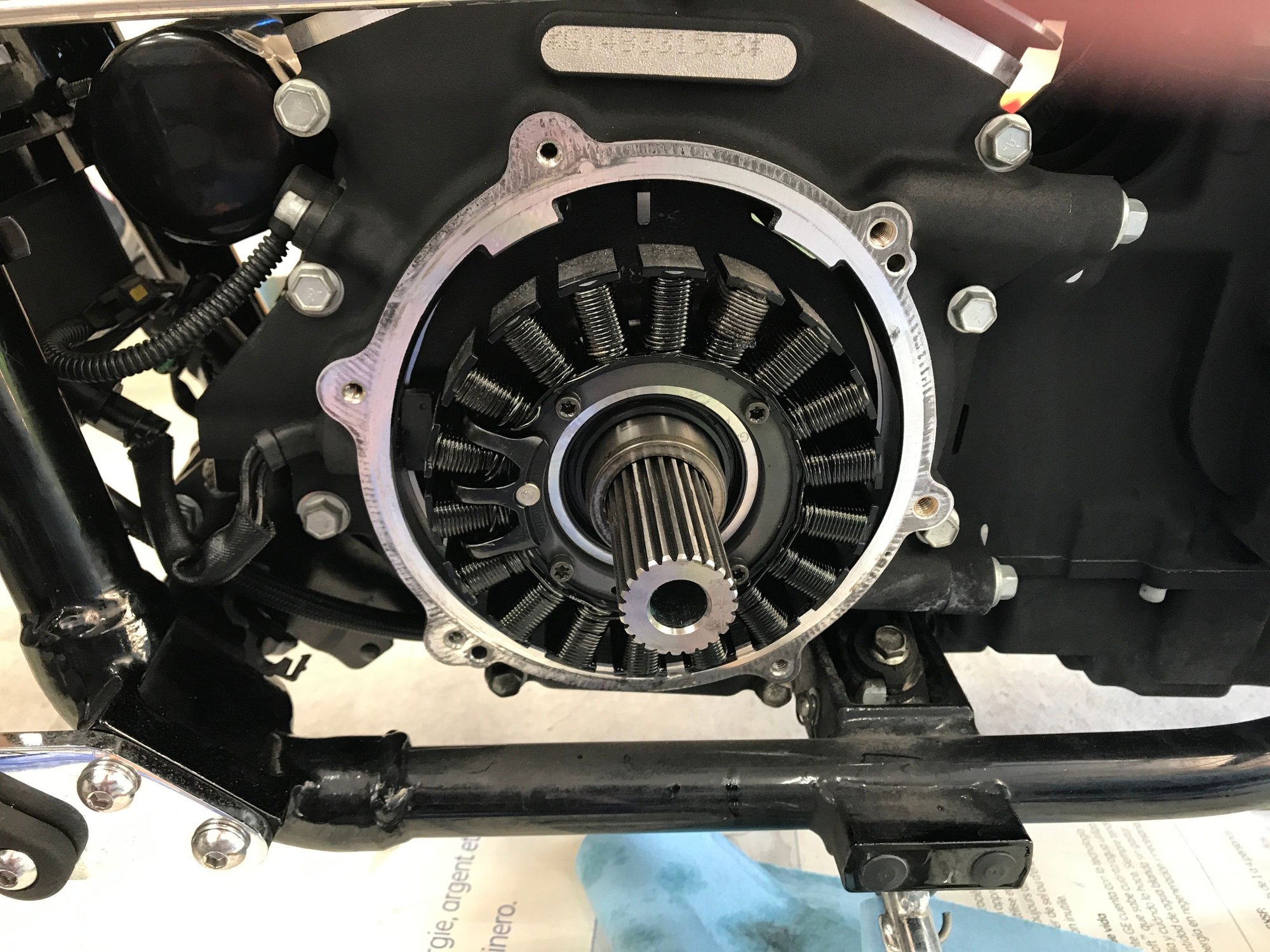

I used both the Cycle Electric Stator and Voltage regulator on my 08 Fat Bob. Very high quality. Here’s a pic of the old crispy stator.
some come like this from the factory. Mine looked like this with 10k when I switched to mids. I’ve never had charging issues still running the same battery for 5 1/2 years
