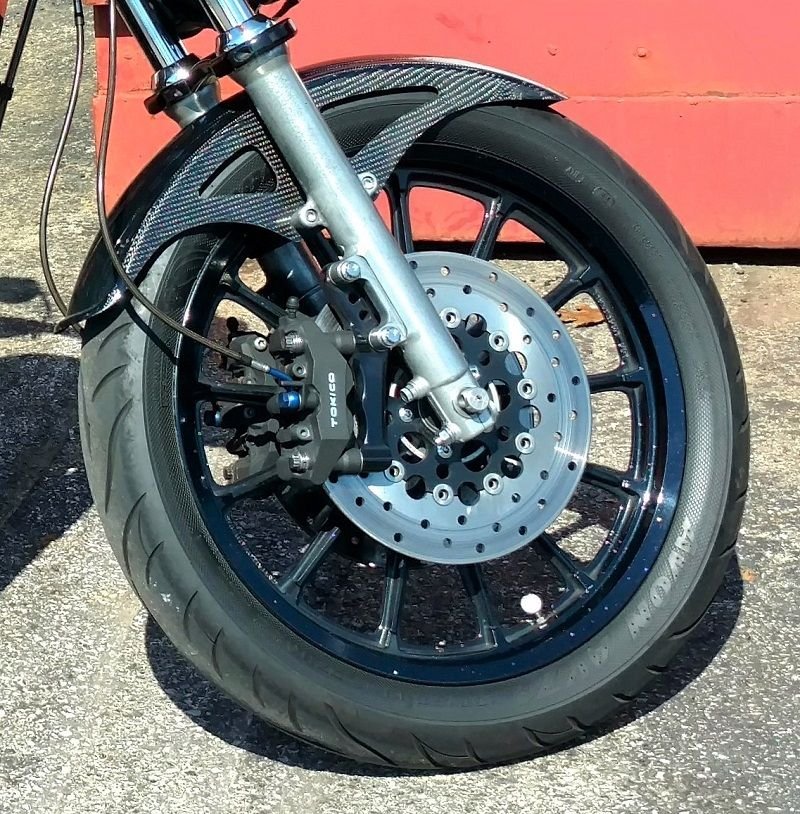

Some stuff has started to arrive. I'm still debating if I want to change the calipers out. Would be for purely aesthetic reasons but after it's a Harley.
Right side with the left side rotor to show the setup.

I had a little extra time today so I did a quick mock up. I'm waiting for the fork internals to come in and the new master so it's a dual disc with one caliper right now.
