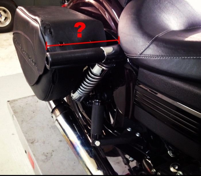

Somebody using this on their 06+ dynas? Is there any recommended length on these?
Reason I ask is that I have some delrin sliders laying around and thinking on using them for this purpose. Im thinking on turning some custom spacers and wondering what length you running? Measuring from end of frame.

What is your purpose for these? Looks or actual protection? If those are for protection then they are way too long. Once those things touch the ground they will snap right off if you're lucky. If your unlucky they will hook up on something and get your bike spin and/ or tumbling. Generally the shortest you can make them where they will do their intended job of protecting the frame.

Thanks, but I already know this. Im also running the bungking crash bar. Looks? Haha, it looks much better without these sliders of course. Im doing it for the protection. The picture is just a reference for measure taken from bungking, I just added the red.
Like you said, maybe I should make it shortest possible, just long enough to protect my exhaust. Delrin by nature is very resistant to shattering under high impact and has a slippery quality, making it slip across the pavement as opposed to digging in and causing the bike to flip.

I hate that anytime these bung king style crash bars come up in a topic, someone goes waaaay off topic and starts claiming that the bike WILL flip, that it WILL grab on. I've seen these slide for meters
Anyway. The official site offers 4 inch and 6 inch. I plan on buying the 4 inch.
If i were making them myself? For the least sticking out look, I would probably make them the length that the air cleaner and transmission stick out.
That way on a tip over it can still lay on the side without touching.
Just know that any bend during a wipe out would bend them far enough to lose the protection on the parts that stick out the most(Aircleaner and transmission)

I will lock them pegs tight so those would save the bottom part and exhaust, three impact points each side. The bike is a bit raised and I’m running San Diego customs pegs with angled bottom to give it more lean angle. For upper part the shock sliders and handlebar would take the hit and save the tins, so it should be all good if I’m flipping the bike.... 😅

Not mainly for sliders, but its cheaper and easier to replace the pegs then a damaged exhaust and engine case...
I reckon the crash bar will take the hit before the main pegs, but i have to lay the bike down the check it :P
Hmm, when im thinking about it, the pegs should slide before the crash bar haha. Maybe its not that smart to lock them tight, only the passenger pegs
