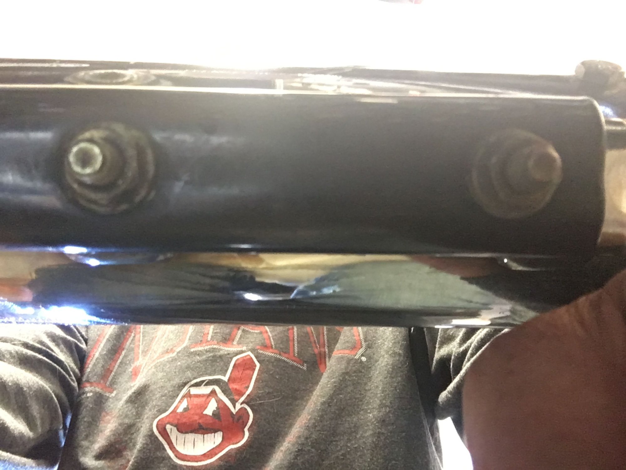

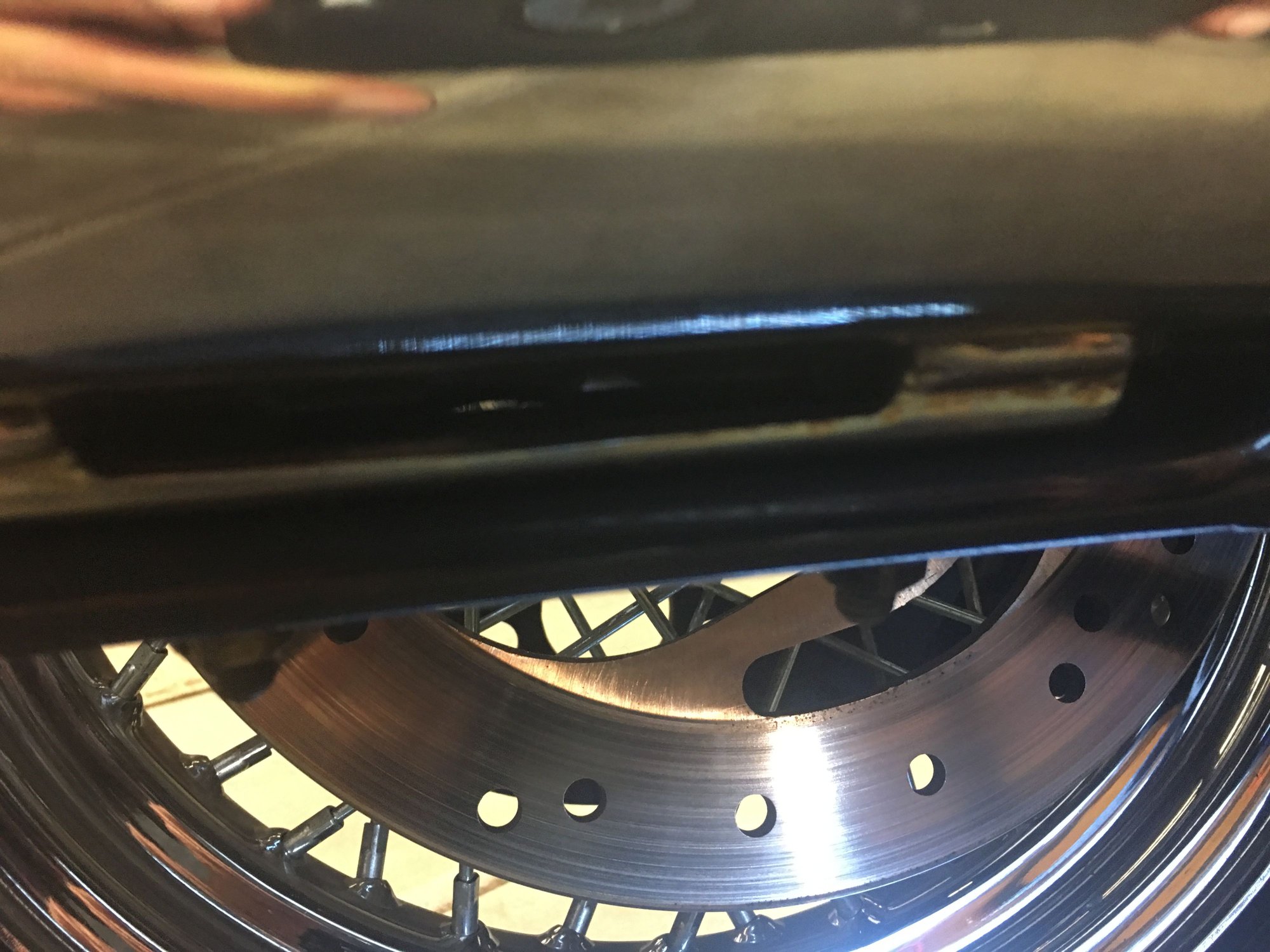

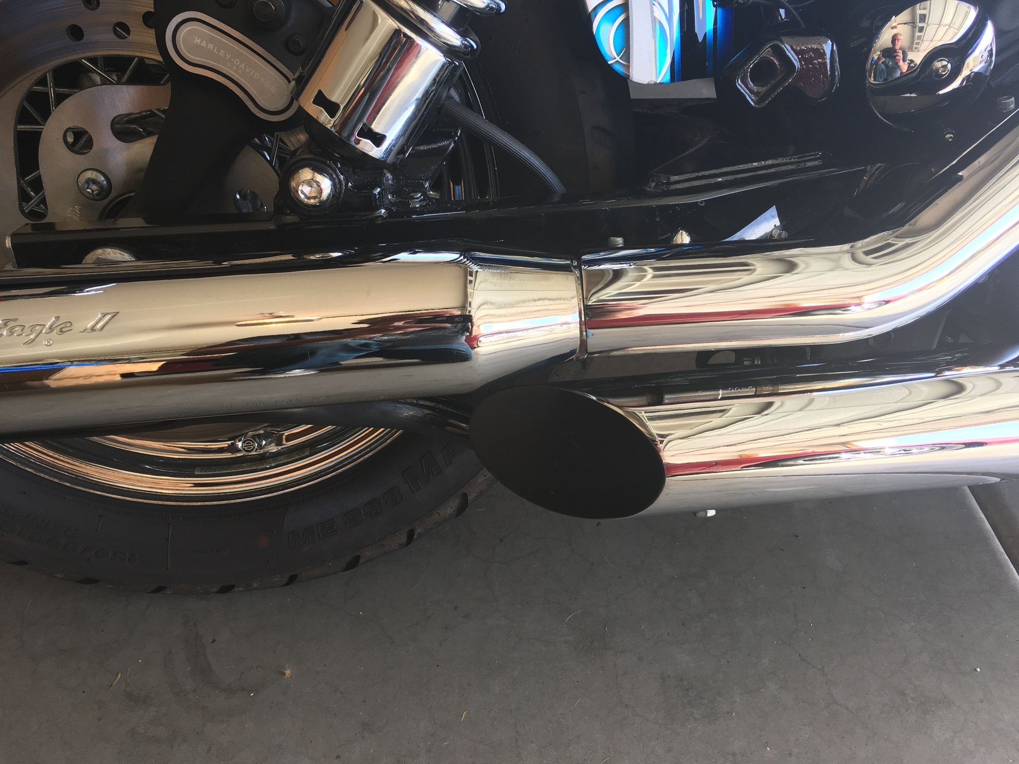

There is a widening fitment gap with my SEII slip on, fitted to my 2003 Wide Glide (3rd photo) Seems there are only three fasteners to deal with, one on the clamp and two on the underside support bracket (1st and 2nd photos). Will loosening these three fastening bolts/nuts allow the slip on to slide forward and close the gap?

Hasty post on my part, 3 bolts, five minutes (including repositioning the clamp to get a ratchet to it) and all good
