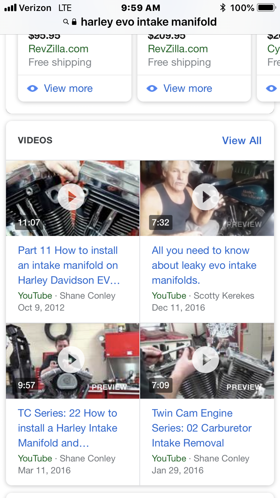

Thanks. I did not replace the fuel line and I checked flow through it albeit into a gas container. I will keep that in mind. I'm going to remove the carb again and go in and check the intake manifold. It is a challenge since you can not get in there with a tool to torque the bolts. I had to purchase a special wrench just to get access. I tried a number of combinations of sockets, u-joints and extensions with no luck. I don't want to bring the bike to a dealership for two reasons 1) cost and 2) distance (over 60 miles).
i hear u about hard to get an accurate torque o the intake bolts pita! You can try the spray test to check for leaks . Good luck with it.
If you google Harley Evo intake install these videos are very helpful.
