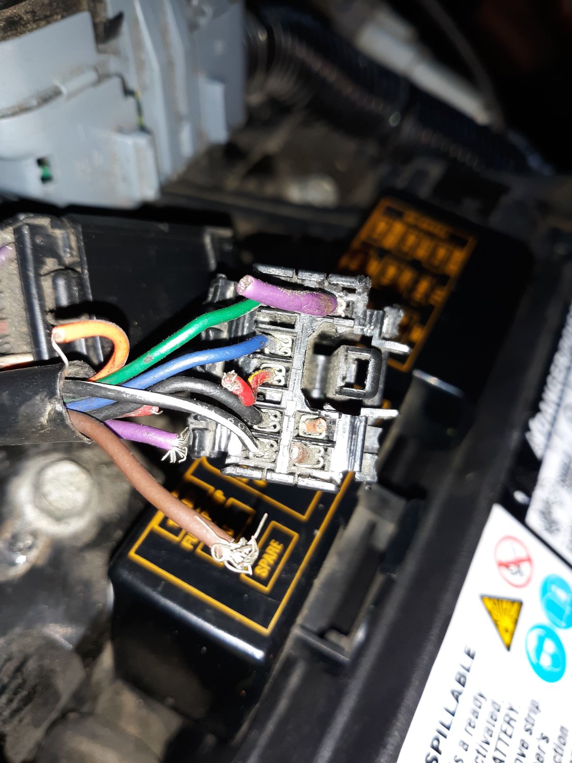

Check wiring at rear fender light connector under seat. Just helped a friend fix his. Hit a big pothole on soft tail. Previous owner had jammed box for run, turn, stop plug in adapter under fender for some reason instead of just leaving under seat on top of fender, broke wires on it too.
