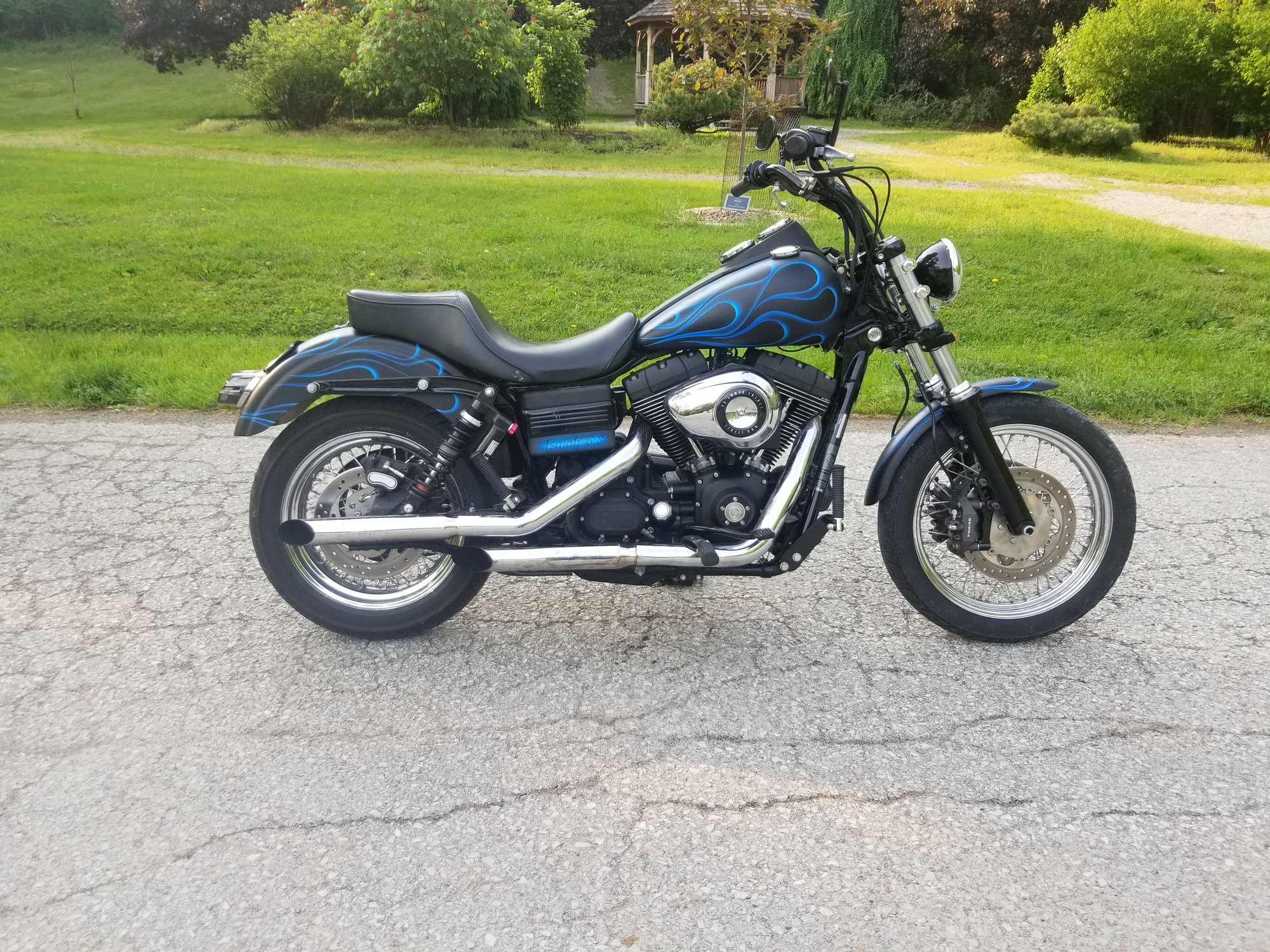

Over winter I rebuilt my 2008 Street Bob. It is more of a Low Rider now than a Street Bob. Here's a list of what was done to it:
  • Installed a low rider tank/console so I could get a tank mounted tach.
  • Predator front mount, rear Sputhe positrac, and upper heim joint engine mount.
  • Shocks: 13.5" RWD RS-1 on the rear and RaceTech gold emulators & springs up front
  • Converted to twin disk brakes. Used Tokico calipers & Speed Merchant radial brackets along w/ a Low Rider lower right slider. Also swapped out front master cylinder to one w/ a 11/16 piston.
  • LED rear light - integrated brake/running/turn & eliminated stock turn signals which hang out. LED front turn signals mounted on the forks.
  • Replaced stock top triple that had integrated handlebar mount with one that now has a separate riser. Added a riser w/ 8" height & 2" setback along w/ motocross style bars.
  • Road Warrior 1/4 fairing w/ 11" shield.
  • Tank, fenders, derby cover custom painted (satin black w/ blue flames) & fork brace, belt guard, lower sliders, brake & shift lever powder coated gloss black.
So, do I call this a Street Rider or a Low Bob. I'm thinking Street Rider.

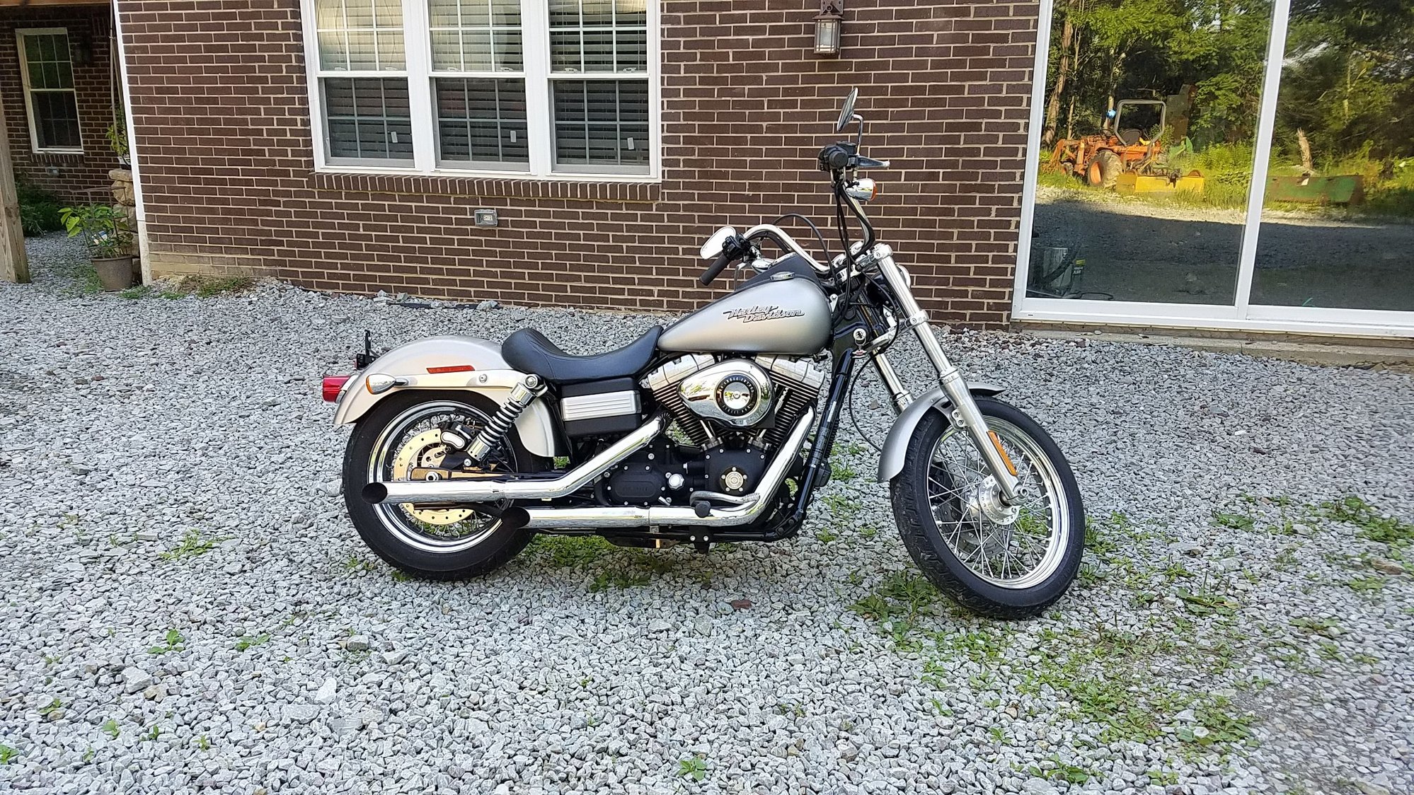

Before the transformation:

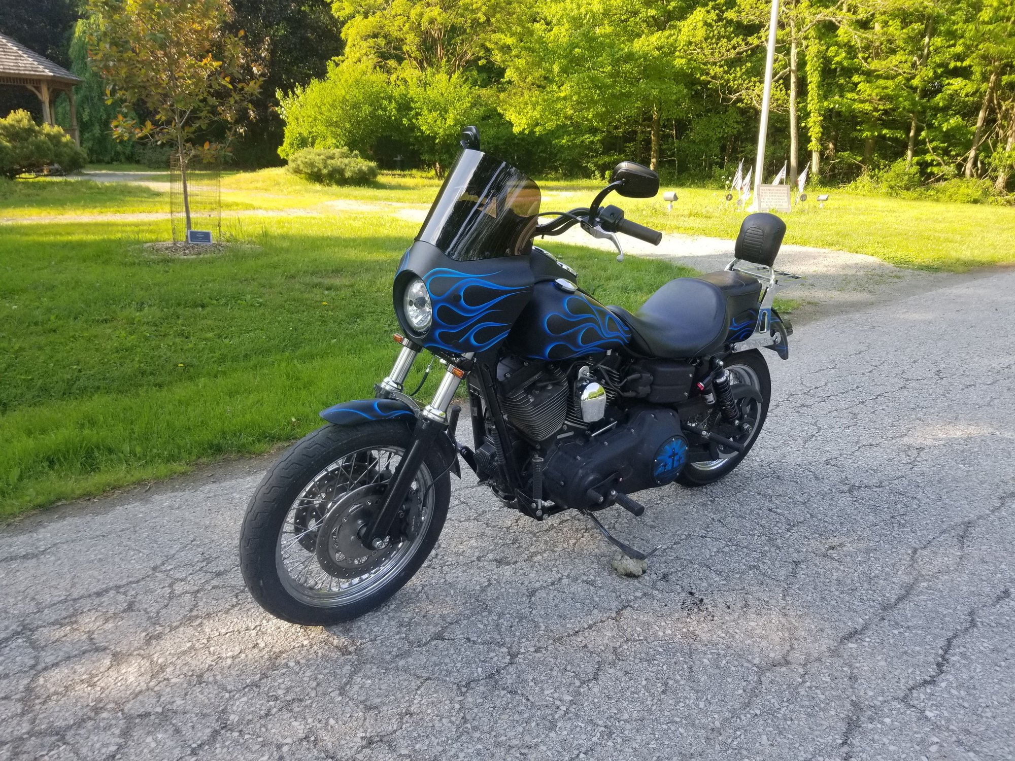

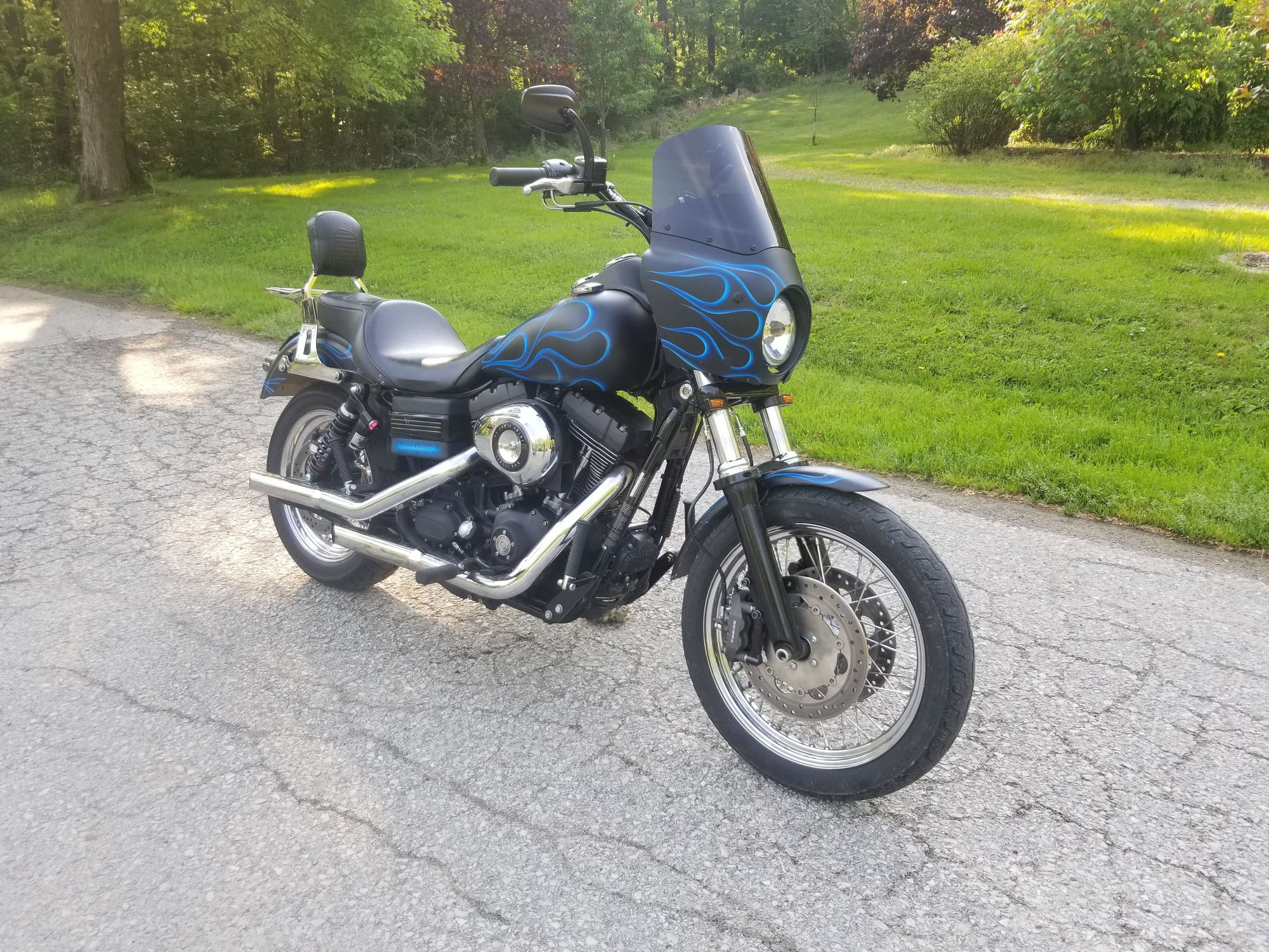

Now, first w/o fairing & sissy bar:
Now w/ fairing & sissy bar:

What makes a Low Rider a Low Rider? I figured w/ 13.5" shocks, dual disks, mid-pegs, tank & console that it was more of a Low Rider. Maybe it's just a thug/club bike. Anyway I really like it & it handles/brakes great!
