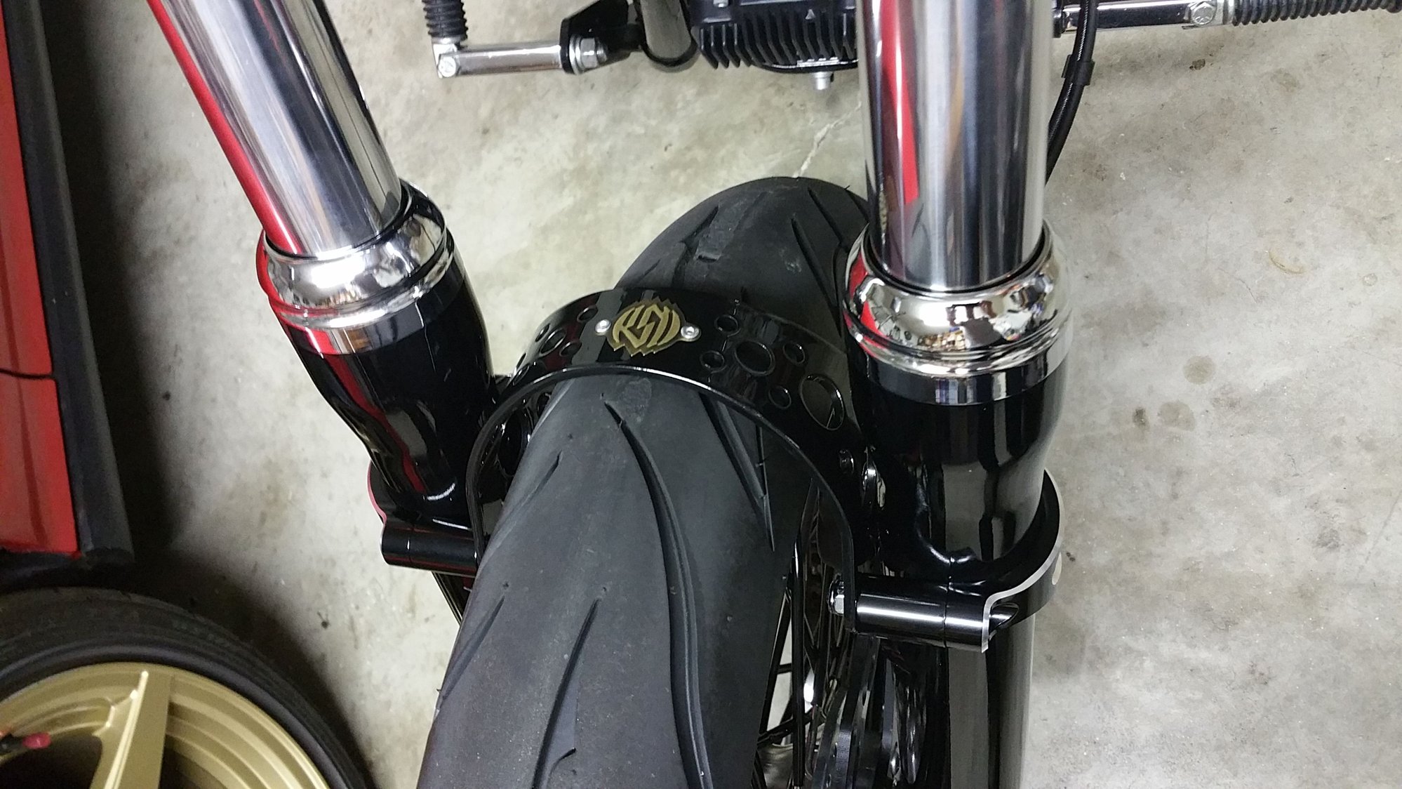

LoLove my RSD brace. Fits, looks, and works good.
So you remove the fender to use this?
Yes sir

You do not remove the fender to add a Superbrace.
You center the bike and fork and clamp it on.
Today I had to remove my forks because I am upgrading to cartdriges. I didnt break the drain plugs. So I put the superbrace back on and it held the lowers so that I could break the drain plugs.
So it offers stiffness to the lower fork in every plane.
Easiest thing to install you ever added.
Use locktite.

Worked for me.....because I wanted the fender gone
