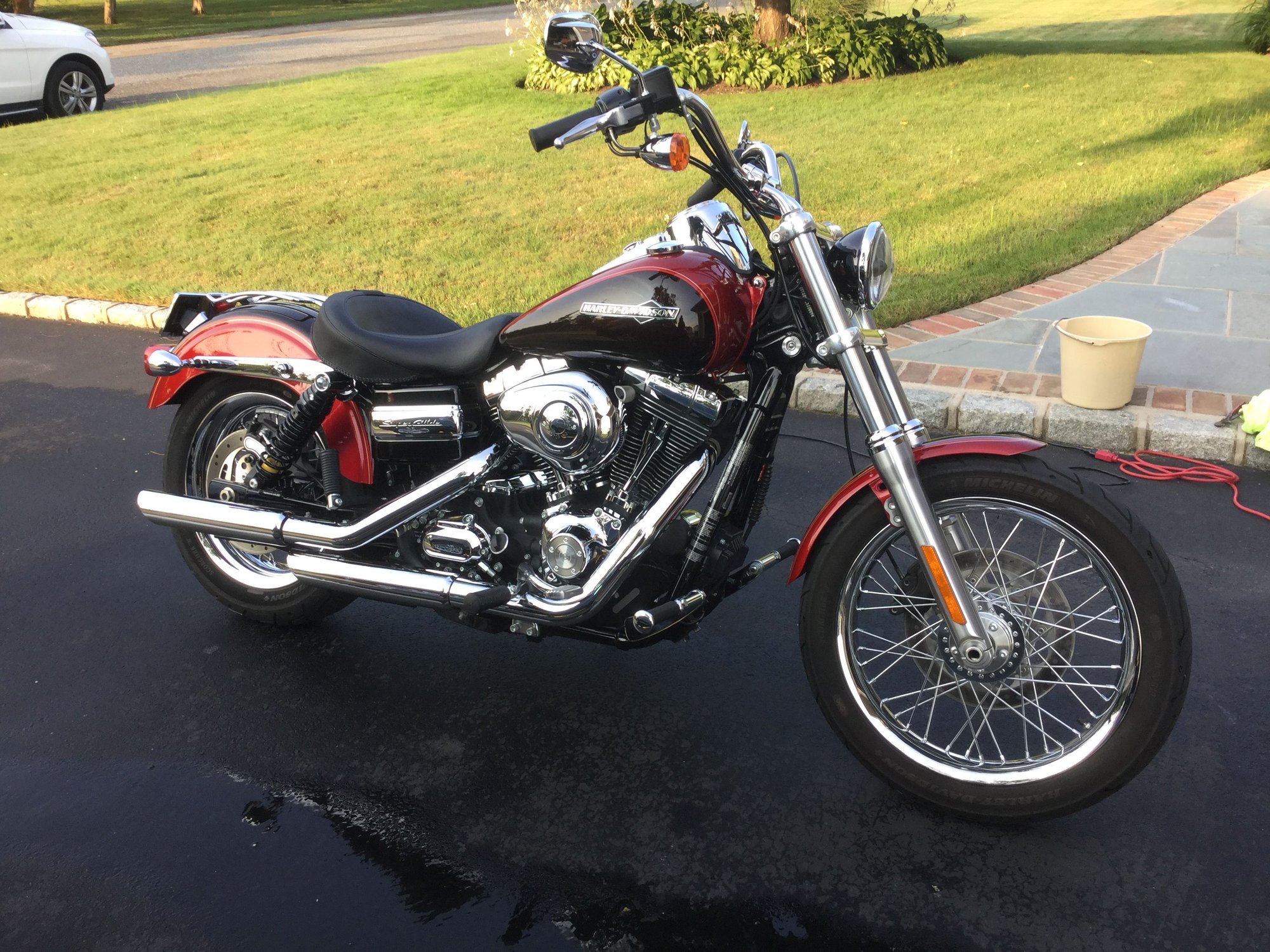

I own a 2013 FXDC and added a riser with no problem. It raised the bars up and back a bit. Made a world of difference.
