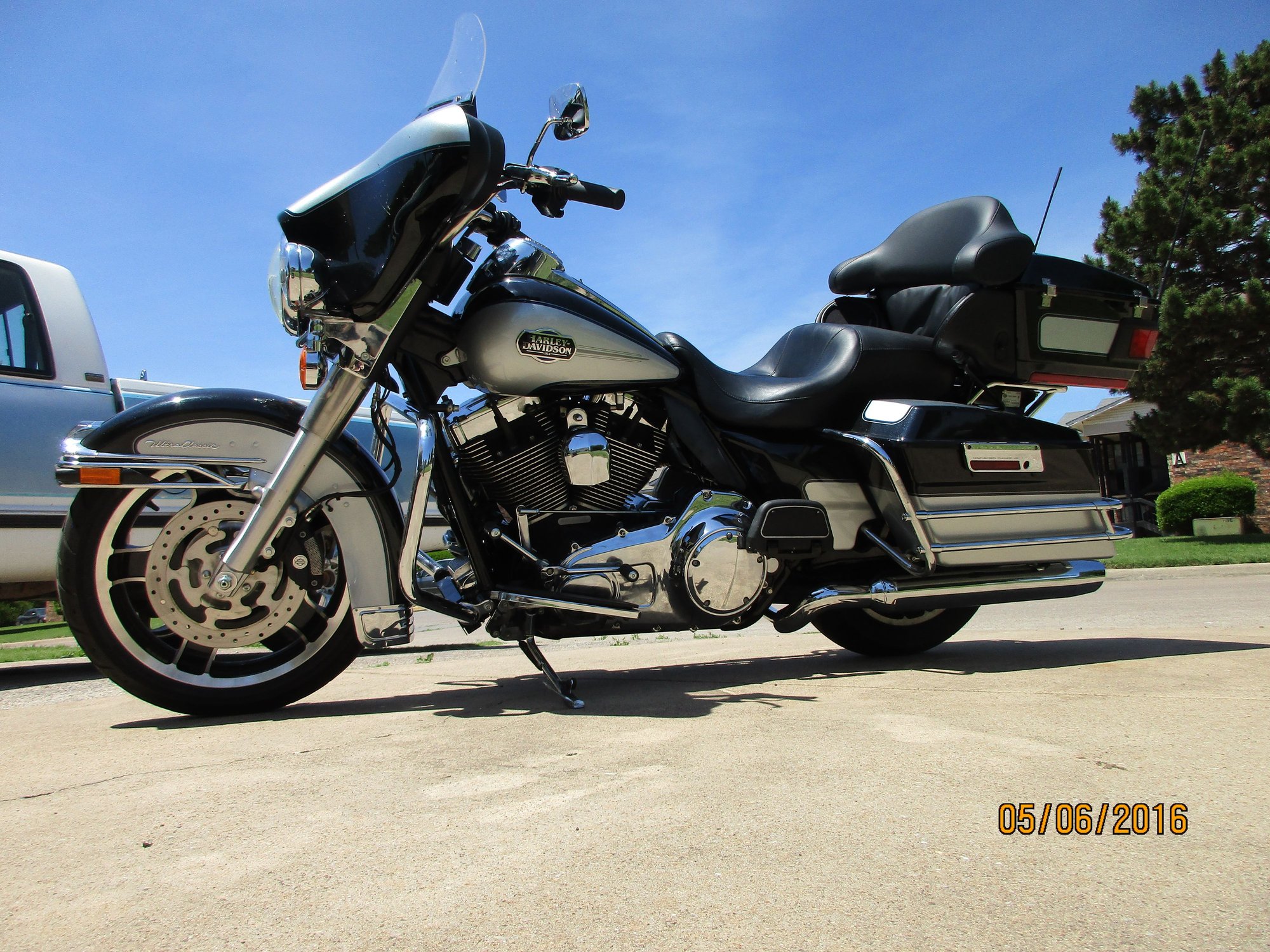

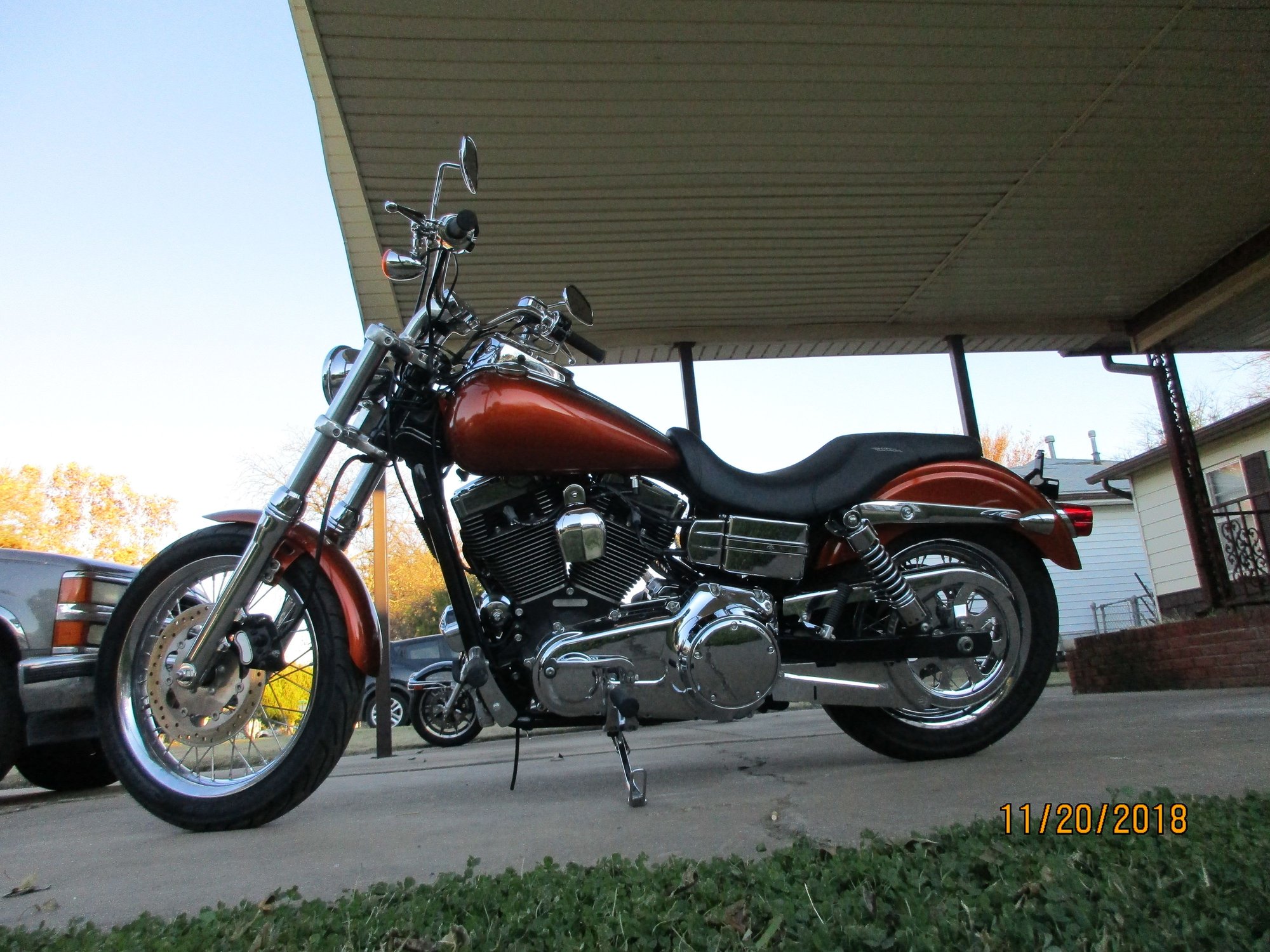

These are my bikes. The engine that is in my '06 Dyna was removed from My Ultra when I installed the 120R in it.All the mounting points on the cases are the same, and will mate with your '06 Dyna trans and frame just like the 88" you have now. The top mount on the Dyna is different than the touring bike, but yours will bolt to the new engine perfectly.

It will fit. Simple bolt in swap.Your ecm will need to be reprogrammed for the new engine.If you don't already have a tuning device of some kind, add that into your cost estimate before making up your mind.
