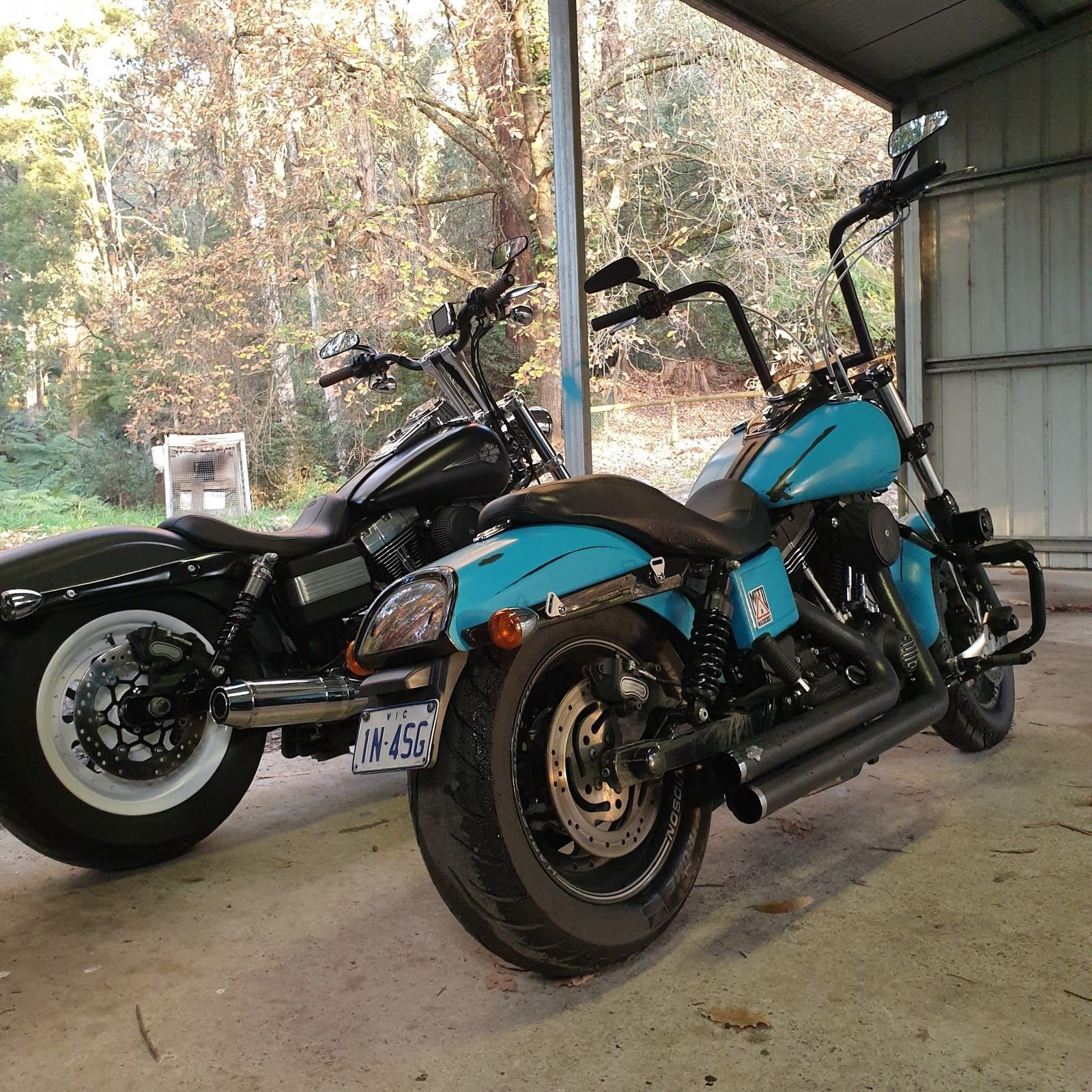

Thnx for the info! Has the bike pictured been raked?
No Standard rake
But I doubt adding rake will not make you any more comfy though.
