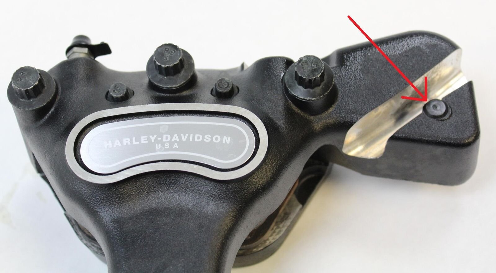

Originally Posted by WS6 Formula
Are you missing the rubber bushing?
I'll check as soon as I get home tonight! the sound seems to be coming from further forward than that but I'll definitely take a look.

You can get brake clunk simply by having some play in the pads. My 17 RK does it.. It's possible that the brakes pads simply have too much play in the caliper. The spring clip might be damaged. I'd pull the pads and look a them and the brake pins. While pulley bolts were mentioned, what about brake rotor bolts? Also if you have buttoned rotors, the buttons may simply be loose,.
