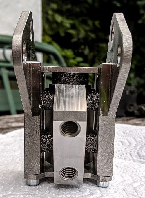

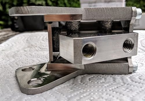

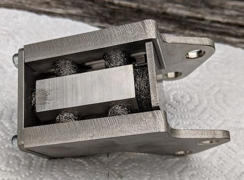

Looking at the mount, I can see how their statement about not needing stabilizers could be true, although we won't know until riding. The instructions explain that the lateral mesh is much stiffer than the vertical mesh, and looking at the mount, it's obvious that separate mesh stacks are used in each direction. Here are a few shots from different angles:

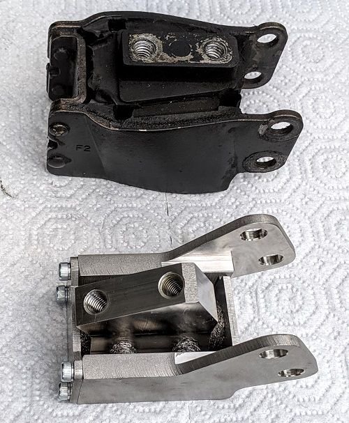

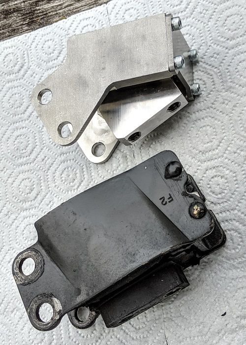

Being a bit of a pack rat, I was able to find my original OEM front mount for comparison. Side by side, you can see the new Kinetic Structures mount is less bulky than OEM, and has a much tidier, smaller look to it. They weigh almost exactly the same amount, although the new unit is marginally lighter: 1lb, 14.7oz for OEM, vs. 1lb, 14.1oz for the mesh unit. The literature simply says "stainless steel" with no further detail. Using a magnet pick-up tool, I found only the slightest of magnetic qualities to the case, whereas the mesh itself held the magnet a little bit more, but still not much. The new mount definitely has a higher quality feel to it than OEM. Here they are together:
