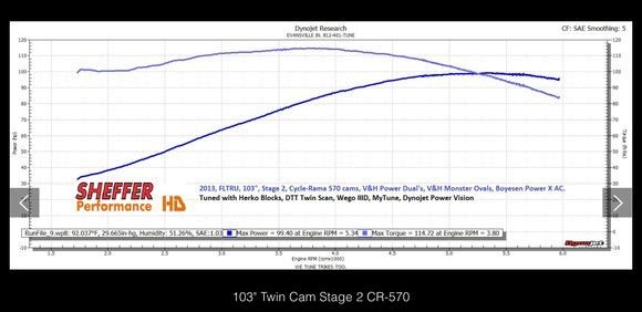

Old Oct 6, 2019 | 02:48 PM
MacKo2000's Avatar
MacKo2000
Joined: Jul 2012
Posts: 234
Likes: 6
From: Gulf Breeze, Fl
Originally Posted by Rollcage
That's better than my 107.....I have stock head nd throttle body. 2n1 exhaust. But that 103 with the cyclerama looks awesome
Old Oct 7, 2019 | 07:46 AM
snake_eyes's Avatar
snake_eyes
Joined: Aug 2019
Posts: 3,141
Likes: 1,924
From: Unreconstructed
Rollcage, can I get some more info on your engine? Any other mods beside filter, exhaust and tune?
