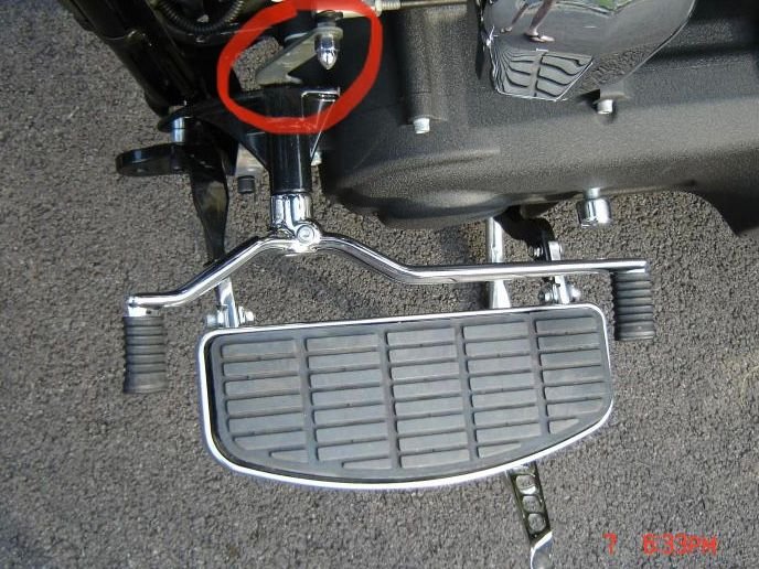

Need help identifying the inner shift shaft part # on OEM FXDP or the Wyatt Gatling floorboards. Mine is stripped and I can’t find a comparable...I emailed Wyatt Gatling to see if I could get a replacement piece and never got a reply.

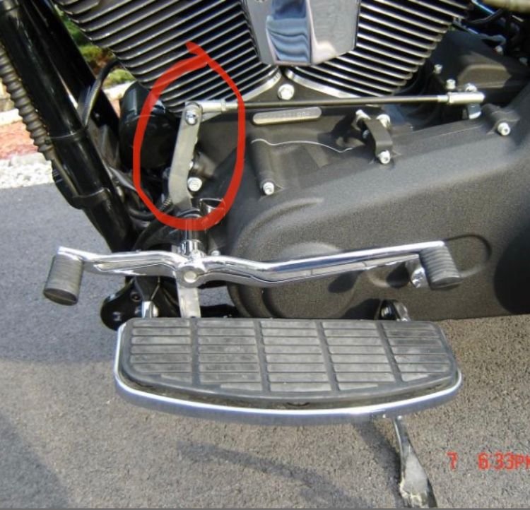

I’ve circled the piece below. I’ve found some drag specialties “forward control inner shift shaft” that might work, but the arm piece curves the opposite direction (see second photo).

Good morning. Here is what I have in my H-D SIP Portal page. If you haven't already I have attached the link to the Harley Davidson service information portal for dealers and independent operators. You can register for free and input your van and get a variety of information without paying for a subscription. At some point in the future I will be paying for the subscription
however I will have to soften up the back with a foot rub.
These are the part numbers that you're looking for for the shift lever for the Dyna Defender or Police model that you have.
34621-90 Shift Lever FXD (P), FXDL, FXDX, FXDXT
4017 bolt
6016 washer
7507 acorn nut
The Drag Spec piece is definitely wrong. Remember, the FXD's were basically the same from 1996-2005 and so all used the same parts. There was a mild model refresh in 1999 that was mostly mechanical, therefore the parts still apply across the model line. The exception is the model wide glide designated FXDWG. The FXDWG, due to its design, was only able to share some body and frame components with the Dina Lowrider the remaining drivetrain components were XL/FXD specific. I failed to see in your post what model year your FXDP was. I can only assume it is a '96-'05 FXD, not a later model tribute build.
Good luck on you parts quest.

Thank you for the replies, and here’s my concern on the cross-referenced “FXD” vs FXDP parts. When I put part # 34621-90 into google image, these pieces came up which is the “wrong part” I posted as the second photo in my original post. I think that’s a normal inner shift shaft from mid controls?

Here’s some google shots...the FXDP part curves to the right vs the left like the other piecwa appear.
Old Oct 6, 2019 | 10:31 AM
multihdrdr's Avatar
multihdrdr
Joined: Oct 2011
Posts: 11,175
Likes: 2,483
From: Nor Cal
33704-01 / 33704-01A SHIFT LEVER "Not Available"
Old Oct 6, 2019 | 10:44 AM
fxdx1985's Avatar
fxdx1985
Joined: Dec 2016
Posts: 855
Likes: 156
that’s the one, thank you! Now just need to try to scrounge something up haha...
