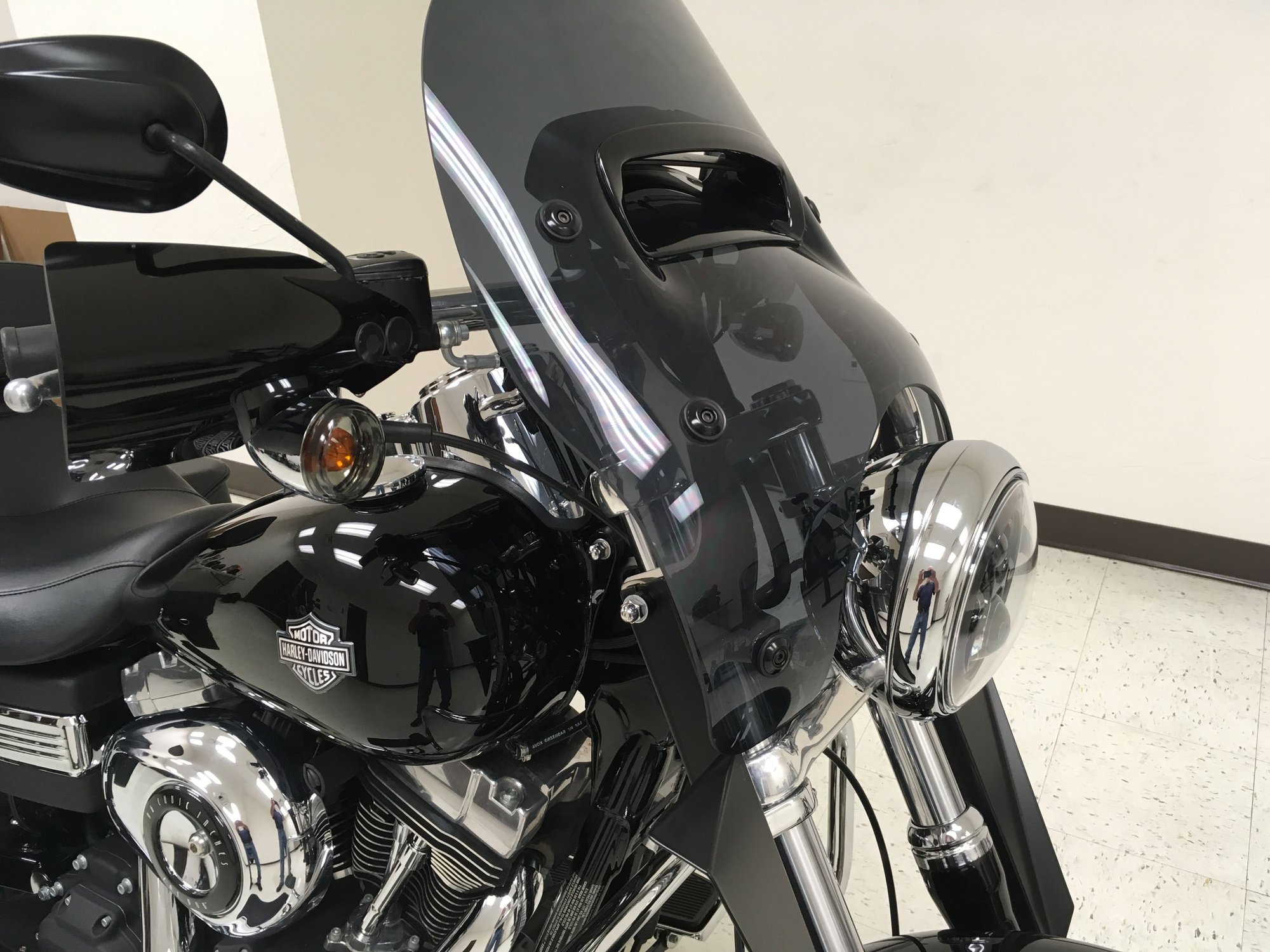

I mounted a Road King Windsplitter using turn signal relocation brackets I also switched to a 7" headlight but ran this shield with the dual headlights also.

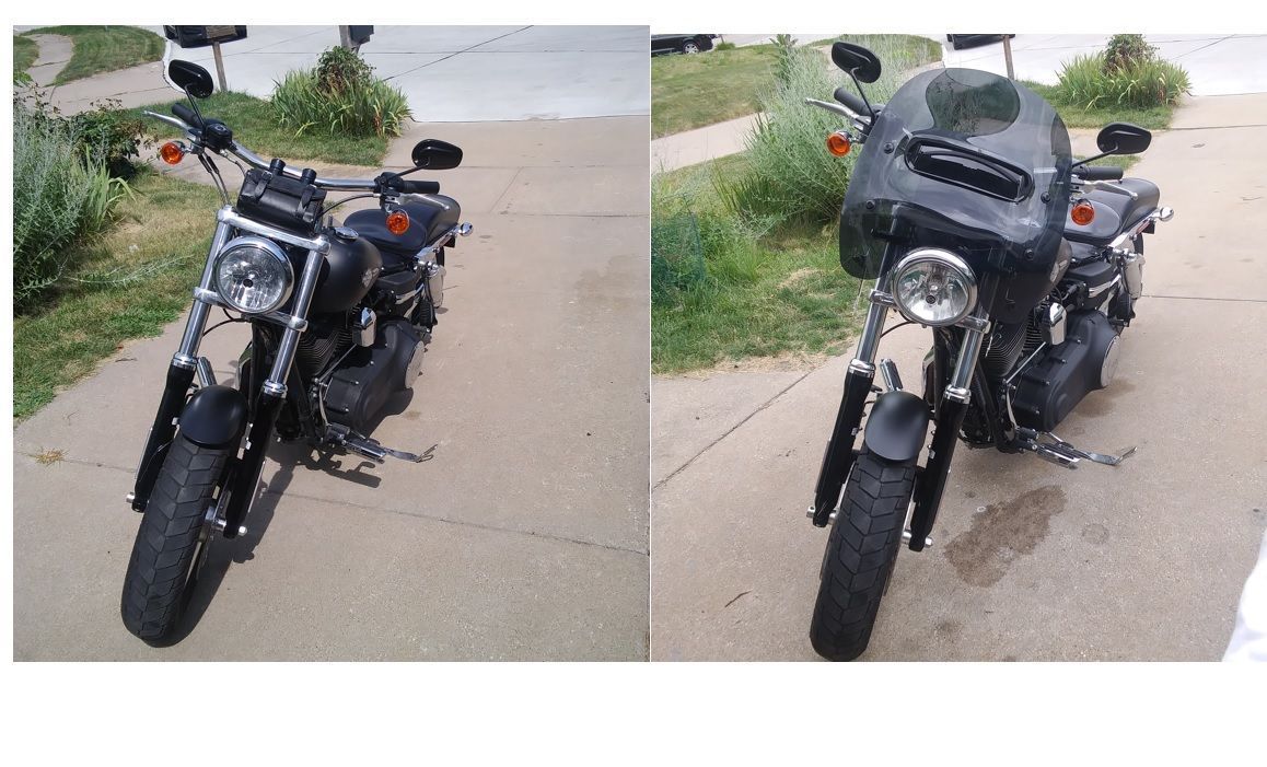

Ditto. Used a Heritage/Fat Boy/Slim headlight with the Road King windshield.

No buffet whatsoever. The vent relieves the low pressure area behind the shield, eliminating the turbulence. The top of the windsplitter is about 4" below my line of sight. I also have a traditional windshield that makes my head bobble. I just like the 7" headlight over the dual light better, but I ran this shield with the dual setup for a year. I also use "fangs" which help a lot too. I have a set of shortened ones that I use when I have my lowers installed.
