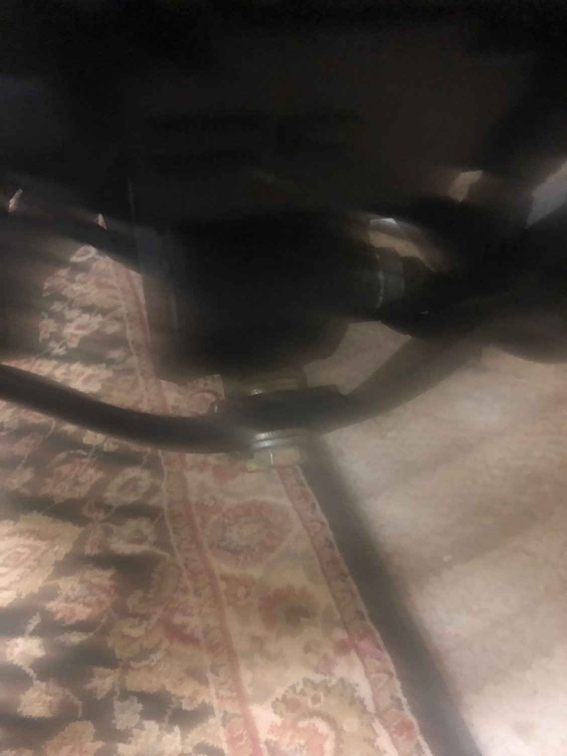

Google dyna front mount shimming & shaving. I started to get a little vibration in my pegs when my bike was cold at the end of last season. I was going to replace but I decided to try the shimming & shaving routine. Works great . Some will say if you are going to pull the mount you might as well replace, well it took about 10 minuets to pull the mount. Isolates just fine for now.

Predator front mount with Sputhe stabilizer and new factory mount rear.
I installed the Predator first then had to lever the engine forward about 1/4" to line up the new rear mount, which required re-doing the front mount again.
Shimming the front mount is probably to compensate for this rearward shift of the power train. Lipstick on a bulldog, IMHO.

Well like I said no vibration and the bulldog tracks strait as an arrow. When it’s time I will go with the predator or the mesh mount. Some have said they experienced more vibration at idle with the predator.
