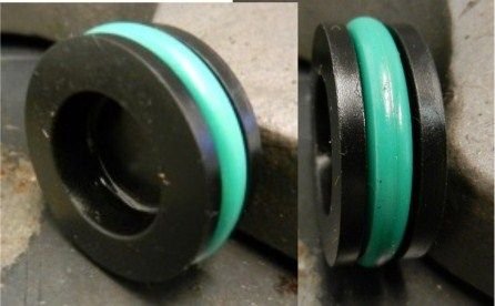

Just because the shock is a piggyback does not mean they are all the same quality. Look at the piston in the movie (Ohlins). Some piggyback shocks have a piston in them, some have a thin wafer as a separator piston with a green O-Ring in them (photo of a Progressive high end 944)
and some have a rubber bladder in them where the shock oil is inside of the bladder and the pressurized nitrogen is sounding the bladder.. All not the same quality, performance, and ride.

I have taken apart a few Progressive shocks apart that people have left after their install here. I have not seen what you are talking about so please post a picture as I have searched the internet for an explanation or a picture. The only thing I found inside of a Progressive 944 was the simple wafer shown above (black with a green O Ring) which functions as a separator piston. If you look at the movie I posted you will see Ohlins typical separator piston. Is that what you are talking about? Thanks a head of time.
An Ohlins separator/floating piston looks way different as it has a piston ring and a O ring to seal the nitrogen in.
