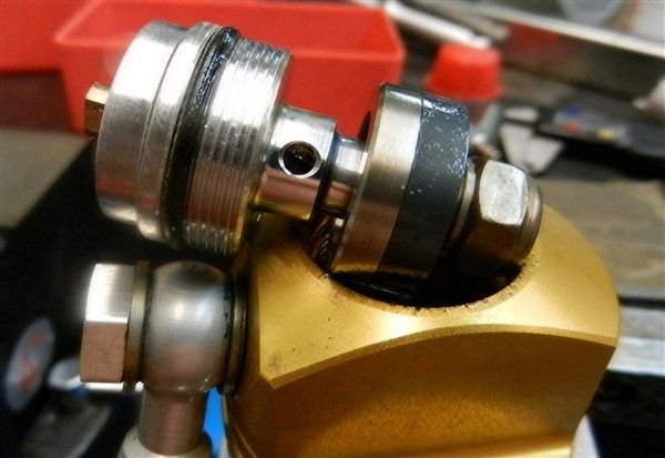

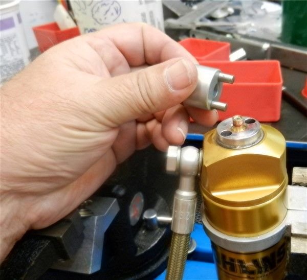

Removing a compression valve & adjuster ****
Compression valve

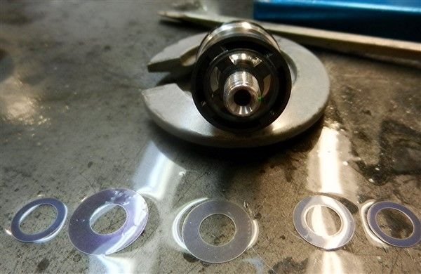

Shim stacks for just the compression valve

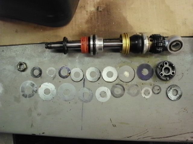

Removing the rebound with the main piston

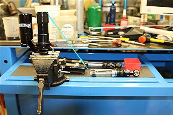

In place of the piston being on top of the main piston such as in an internal reservoir, the "Dog Bone" is integrated on the upper mounting end-eye so it holds the reservoir and the I-Beam cools the hot oil and the main body can allow the piston to travel full length so a longer stroke can be achieved. The gold ressy (off of a HD-357 / #6 ) & the black ressy shares the same separator piston and works the same on both shocks. The separator & ressy are used to eliminating misting, shock fade than shock failure which happens on emulsified (non separated) shocks. Look at the OhlinsUSA demo and wait until the end of the movie when the pressurized air is removed from the top of the ressy piston (on the bottom).

This is the rebound adjuster and rebound shim pack.
