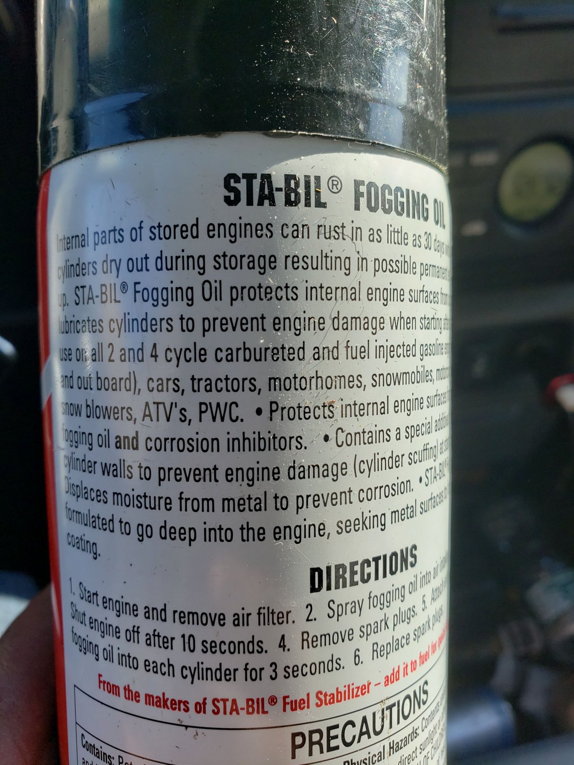

Originally Posted by Sparky357
If you bent a rod you put too much in the the cylinder and hydro locked the motor. All I get is a puff of smoke on startup and no fouled plugs.
The whole point is not to have a dry startup after a long period.
Fogging oil is used to prevent corrosion on cylinders, not dry startup.
According to the instructions it does exactly that.
