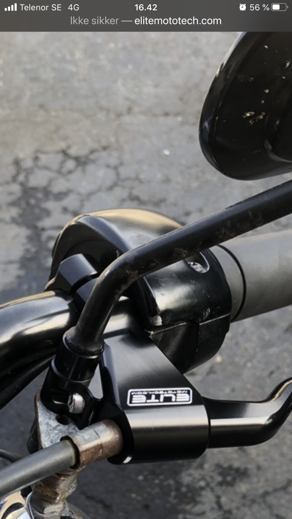

I can’t imagine why that would do anything with the fitment. If you meant the safety clutch button, I don’t know. I don’t have that.
This is my fitment .... shows the clutch switch
This is from there website its a different shell and has no clutch switch

That is not a fitment problem. Like you said, in 2011 HD came with the safety clutch whatever switch. I dont know if the year number is correct, Im just quoting you. Any ways, this button prevent you to start the bike when its in gear and the clutch lever is not engaged. You can still fully use the bike, just start it in neutral or bypass that switch and remove it, I would.
Or go with a lever that have your problem in mind
https://1fngr.com/collections/dyna-s...k-dyna-softail

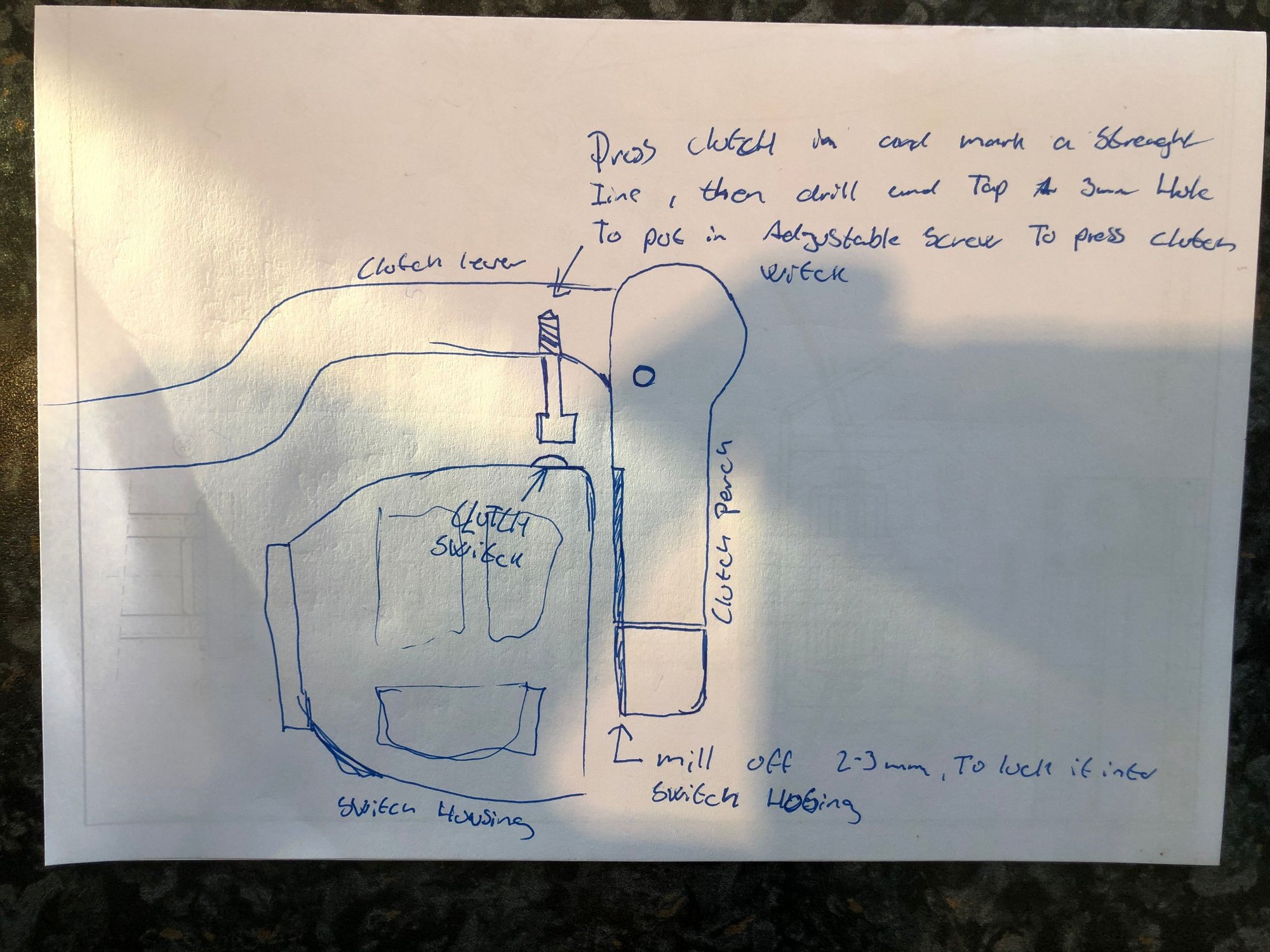

I'd bypass the switch. You don't want to have to find neutral in the middle of a busy intersection... (With my luck, the ecm would do something weird since it though the clutch was always pulled in...) Maybe you can thread a small bolt with a stop nut into the lever to actuate the switch.

Well since im taking the bike to Denmark , i cant bypass any safety systems . But i been doodling and come up with a plan 😂

That's what I suggested above. Make sure the bolt is at right angles to the switch when it makes contact, and put a thin nut on it so you can lock it in place by jamming the nut against the lever, or use red loctite. (Make sure you get the length right before you put the loctite on it!)
yes im gonna take my time on it and not Fĺĺk it up 😂
How would they know?
they do a full inspection of the bike when i want to put plates on it . Denmark doesnt want you to do custom bikes . Do all the mods im doing are “with in” what they say is ok .
Dude, they don’t check the clutch switch 😂 that’s just stupid haha. You could just have the oem lever for the inspection I guess................. 🤷‍♂️

I can do that , but they check out everything , you dont know how many hoops i have to go though just to get my harley home and road legal . Most harleys here is mostly stock couse if the cops sees something they call it to inspection , and the paperwork is a nightmare .
ill mill it to make it flush with the switch housing and just to lock it in with it before clamping it down .
