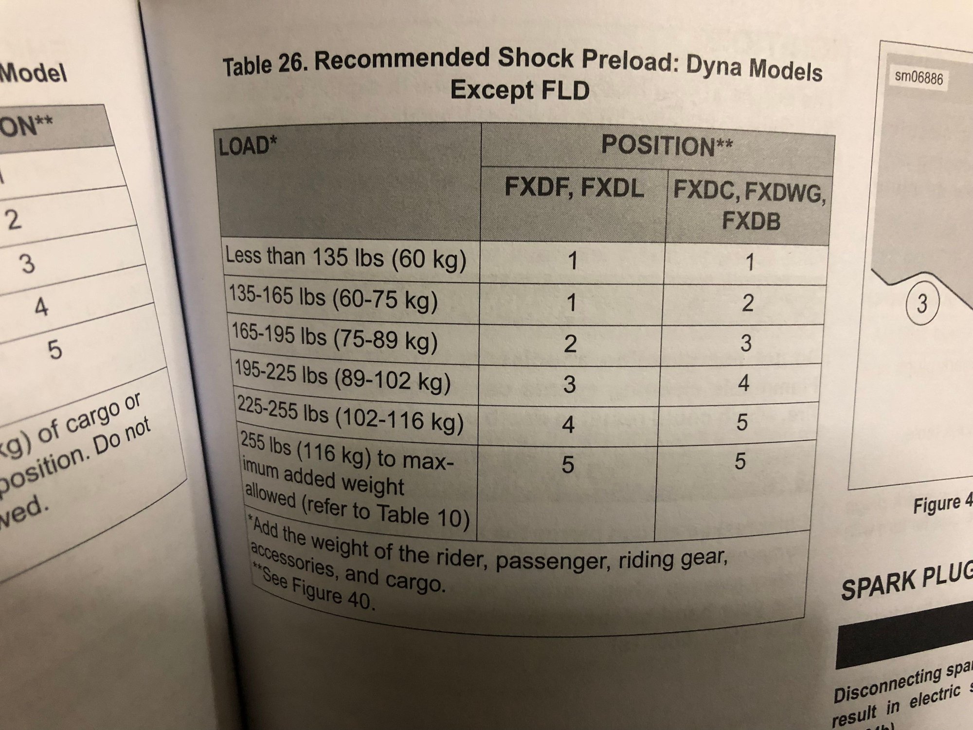

Hey there, Just bought a 2011 wide glide and don’t know how to adjust the shocks that come stock on the bike. I am on the heavier side (290) I know the shock is adjusted with a spanner wrench and I bought one of those today. I couldn’t find any good videos online explaining and showing how to do it. Thank you

I believe that you can find it in you owner's manual, too.

Set it at 5 for your weight. If too stiff back to 4
Replace fork springs. They are mush. Put in Progressive springs.
You will have a much better ide
