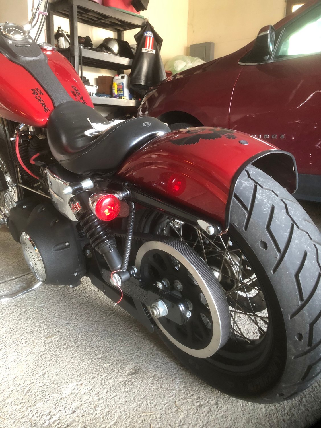

I've been through 2 side mount plates, both mounted on the lower shock bolt, and they have both actually cracked off and flown off the bike. If you look closely at the pic, you can see the cracked area. I'm going to try it on the axle the next time I guess. Not sure why this is happening. These brackets are used on rigids and shouldnt crack?Are their any other options you guys can think of? Id like to maybe mount something that would lie off the back of the fender (like on the breakouts), to shorten that space between the fender and tire. Any ideas please.

Most failures like your seeing is from the ridged mounting at the bolt face or washer face and the unsupported area around the bolt. It flexes just enough that after millions of cycles it cracks and fails Just like a clothes hanger when you bend it over and over.
You may be able to add some large Delrin or UHNW washers between the plate and some larger washers to help absorb some of the vibration, just be sure to use blue Loctite on the bolts since you will not be able to achieve the full torque value with plastic washers, but it should be fine on a shock mount.
What is the thickness of the tag mount that failed?

Not sure what Delrin or UHNW washers are, but I'll definitely look into it-thank you. The bracket was a 3/16th thickness.

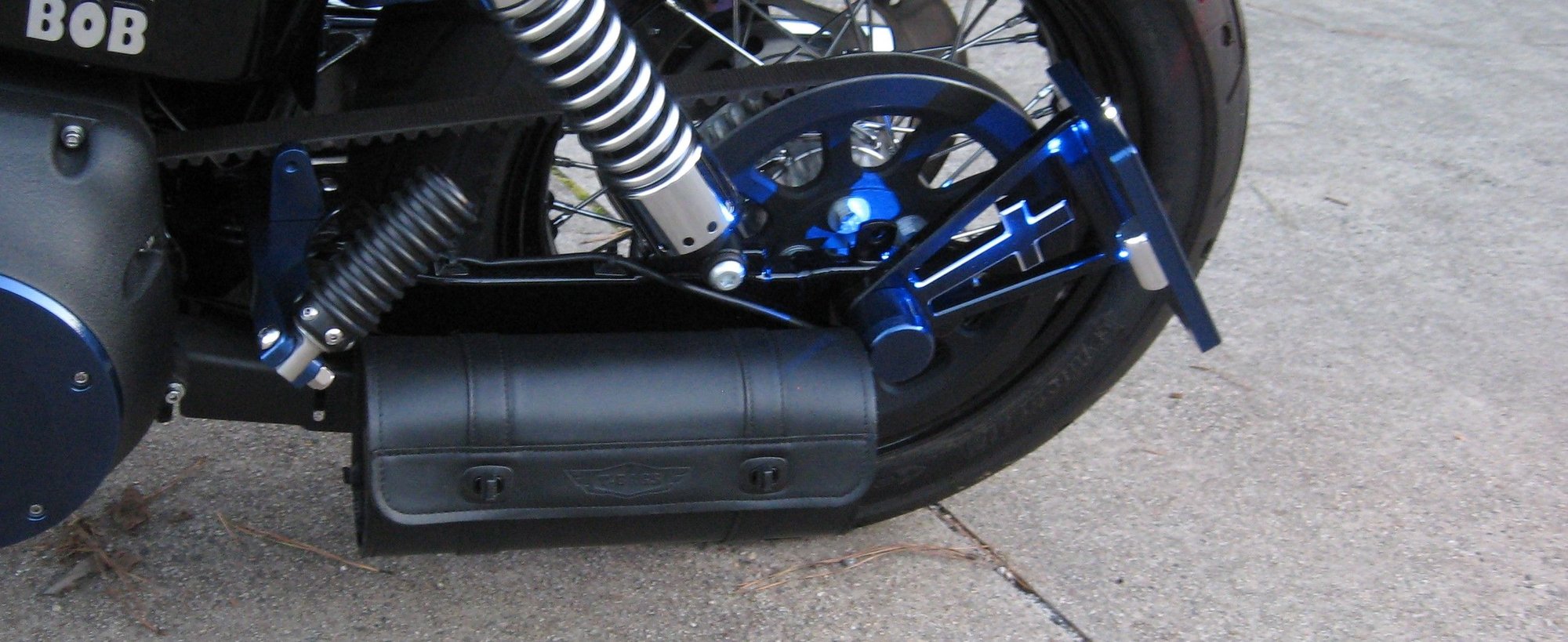

From your pic, your mounted to the axle, correct? Any issues? Delrin washers are the plastic-type? So you recommend placing those on each side of the steel bracket mounts?

Yes mine is axel mounted but is aluminum and close to 3/8" think at attachment point.
I would not recommend Delrin / plastic washers on the axel because the torque requirement would never be reached without crushing / spitting out the washers.
To shock mount the bracket it would be less critical of torque just loctite so bolt does not loosen.
And yes install on each side of bracket. PM me and I can send you a few washers.
