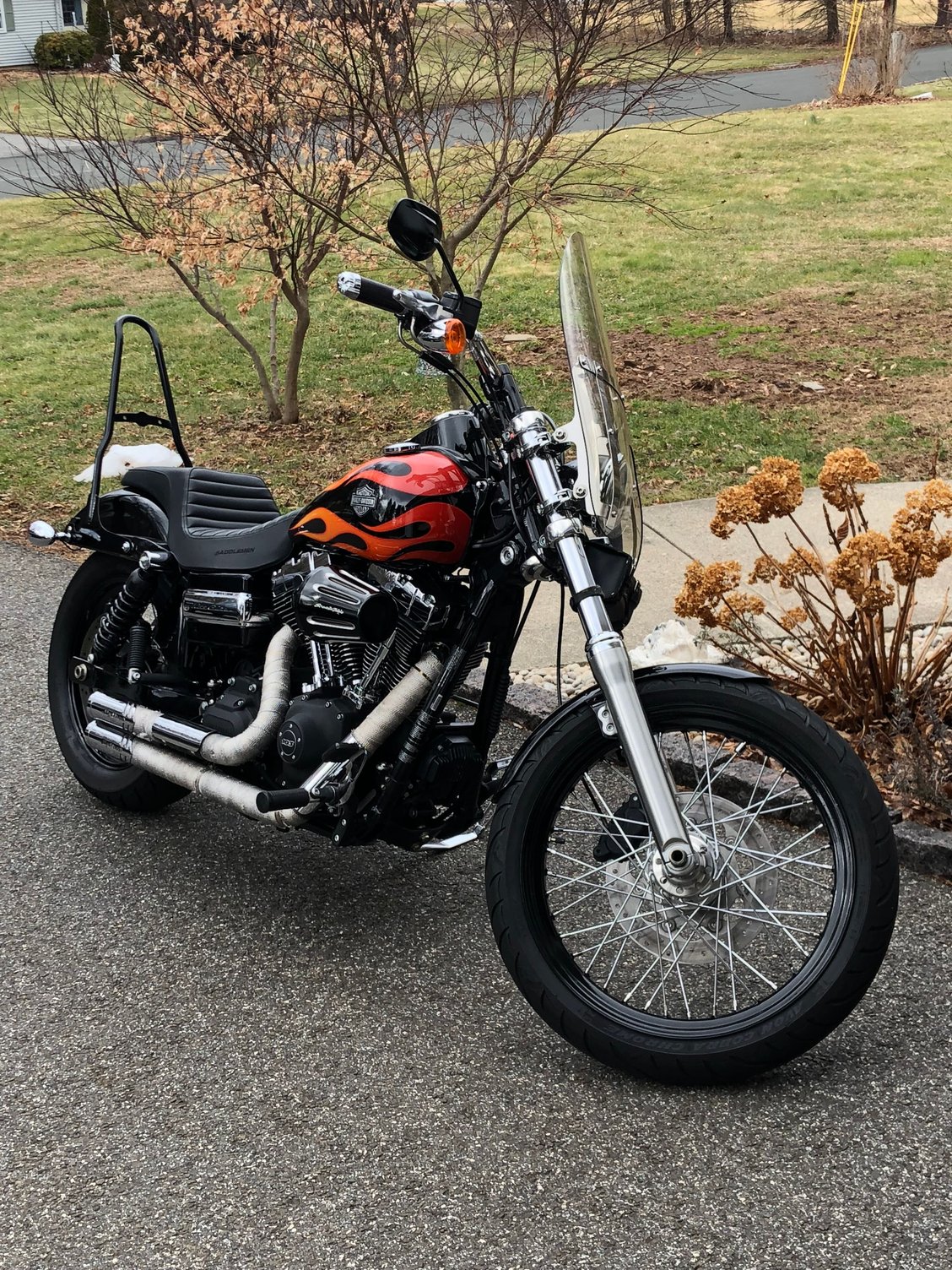

What year breakout fender did you use? I know the mounting changed at some point.

I know on the newer breakouts the fender mounts on one side of the fork just like a 2010 + wide glide.

It’s the early model fender. I just trimmed the length of the mounting brackets and re drilled the holes.

Got my 120mm tire. Waiting for a breakout front fender.

Looks good. Is that a 60 spoke wheel?

thank you. Yes 60 spoke
