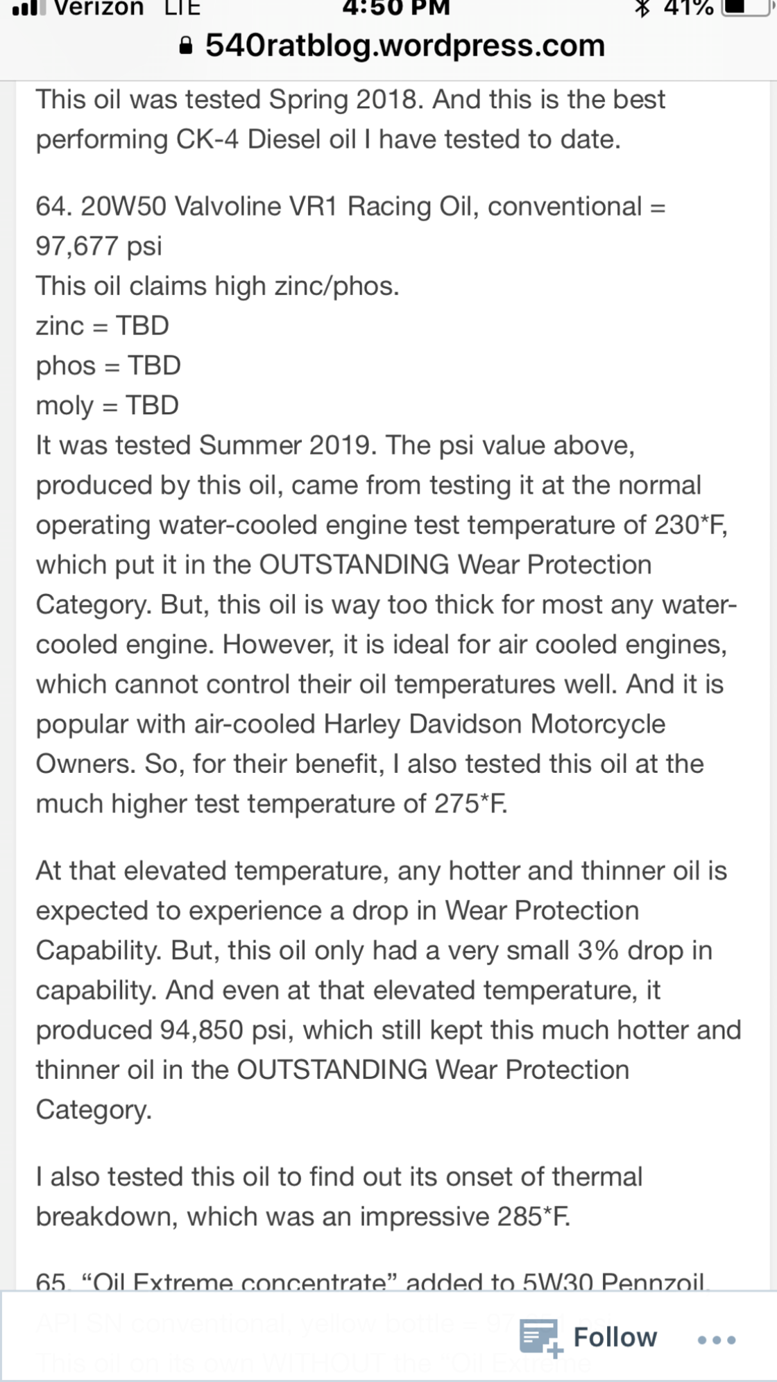

I have cams and head work with my 103. I have run redline 20/60 - spectro 20/60 - valvoline vr1 strait 50 and vr1 20/50. I found that valvolne vr1 20/50 works best for me.i found when running synthetic oils valvetrain noise is definitely louder.
I have read a lot of reviews on the vr1 20/50 and they are all positive for air cooled motors.
