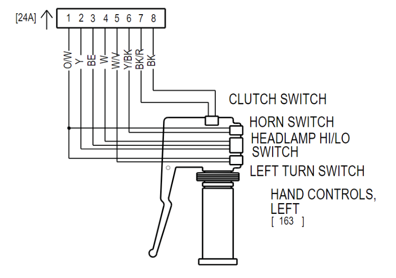

So my buddy and I were working on his 07 Wide Glide last night. We are installing airhorns on the bike. After several hours of work, we were ready to test the new horn. He mashed the button several times and no horn sounded. We finally went to roll the bike forward and as he pressed the clutch, the horn activated. It's one of the funniest things we have ever seen but have no idea how the clutch is activating the horn.

Sounds like you spliced the horn 12 V + line into the wrong powersource (black/red wire instead of yellow/black)...
