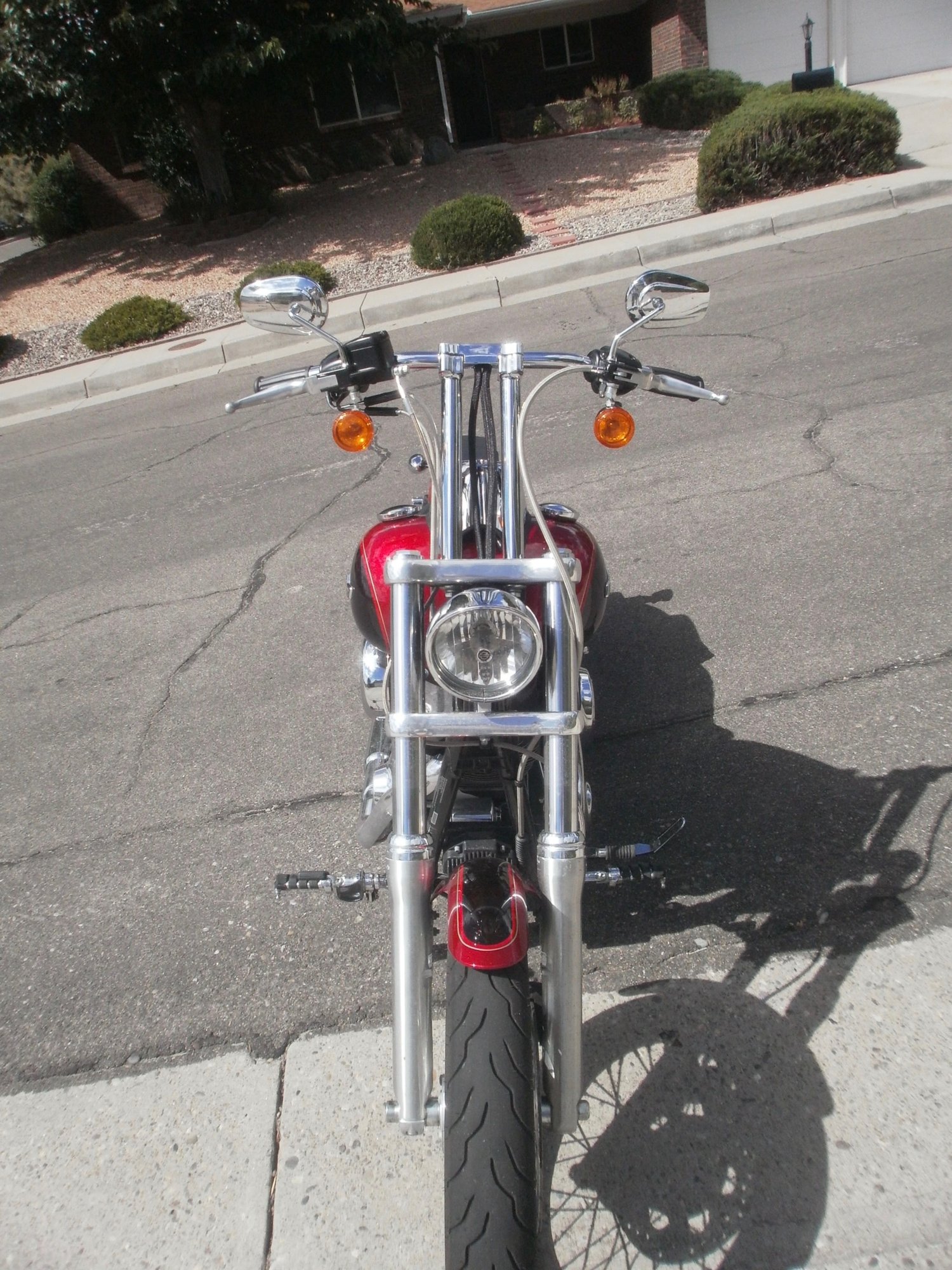

I'm really like the way mx t-bars look but on my WG I'm afraid 14s will come back to far. My previous bars i had rolled forward quiet a bit. Im 6' with a pretty decent reach. Anyone got any input on a set of bars that bend forward some? If i can't find anything I'm leaning towards the adjustable t bars that imo look nothing like t bars

You could try some tall straight risers with some mx bars on them. Then you can rotate the bars forward in the clamp and put the grips where you want them. Drag bars on my risers but you can get the idea:

Check out Bare Knuckle Performance. He just started making some adjustable risers that you can run straight or in pullback just by flipping them around. Killer design and tons of height options.

I was in the same boat , I’m 6’2” with a really long reach , I run 10 in risers with 4 in trackers and have them angled nicely forward . Tbars give you one option where bar/riser option is limitless. No reason to go tbar unless your after the look. Bar/riser looks better imo anyway .
