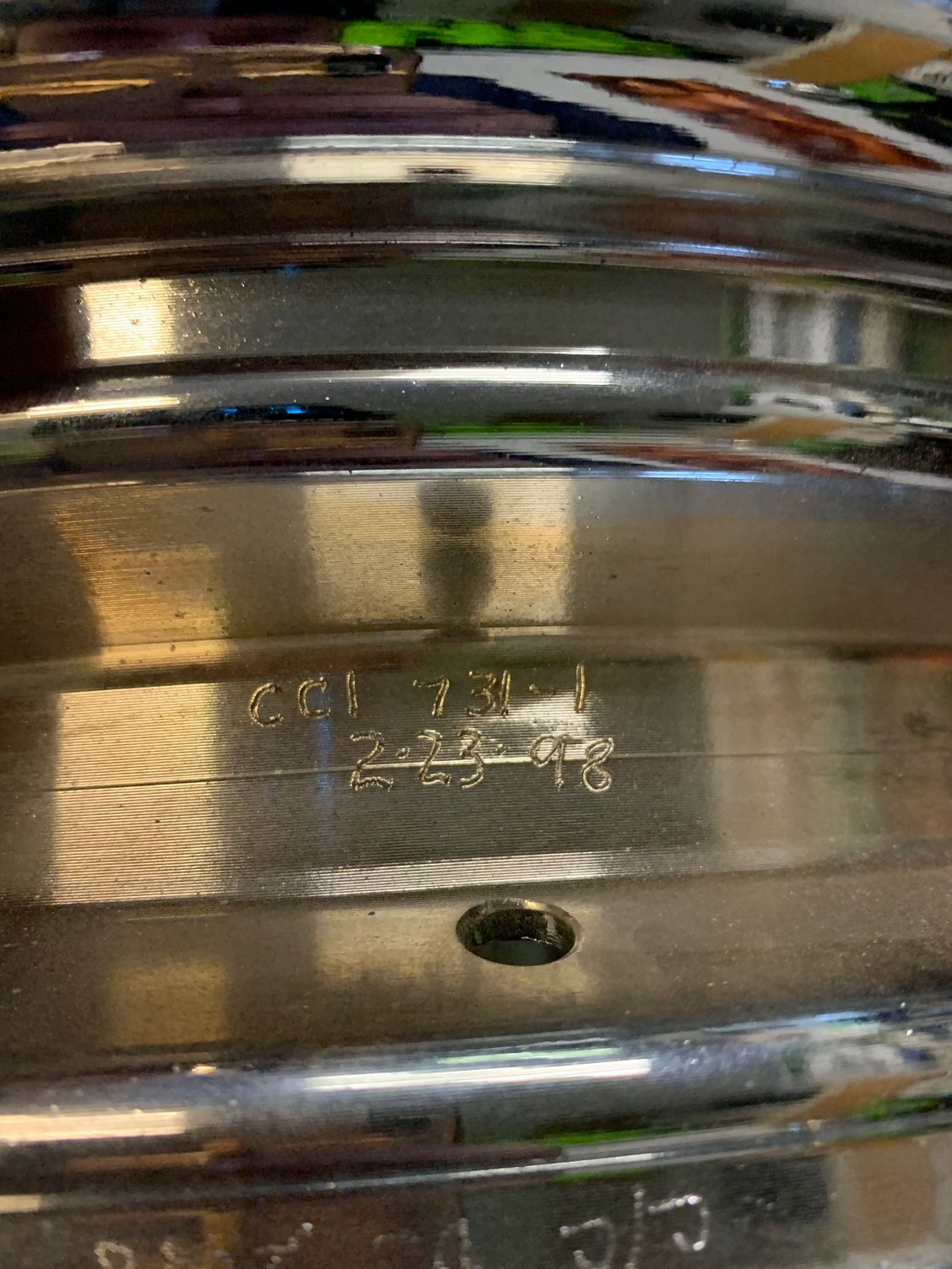

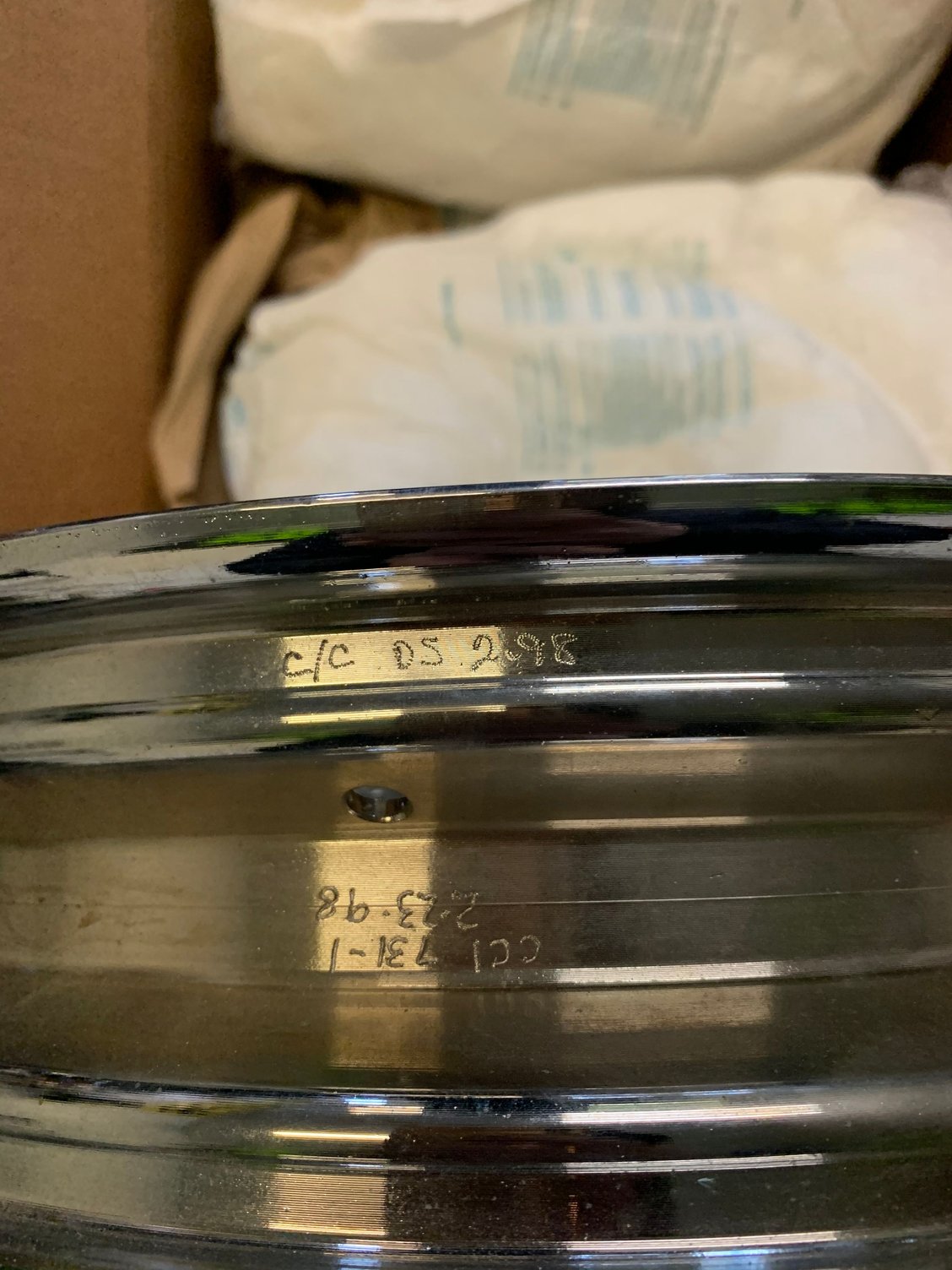

That leads me to this ... I was looking at an old 9 this weekend and discovered something potentially interesting... akprigge, can you post a pic of both your wheels and specifically the rear showing the "writing" (for lack of better word right now )
this what you’re after? these are both on the rear wheel

No, but after seeing the pic of the chrome wheels, it looks like they removed the lettering during the prep for Chroming. Interesting though that it looks like Custom Chrome Inc (CCI) chromed those in 1998.
Here's what I was talking about

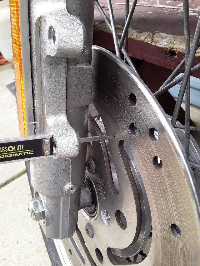

First, let me get this out of the way ... you say you got New '99 parts.
Do you have any measuring calipers? ... Measure the Front Left spacer (part# 43617-95). I see published specs of .930 or .940 ... What do you get?

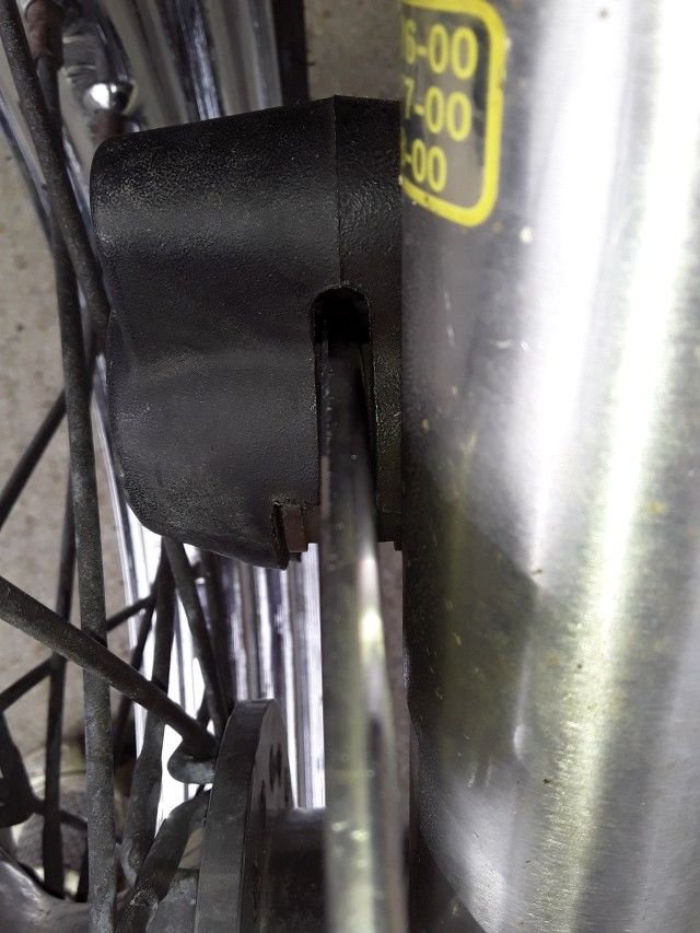

Ok, above I said using the differing measurements of hubs, you would need approx .170" caliper spacers ... so I did a Quick Mock-up
Pics
1. Your 2003 Parts, except I used a 08-later Caliper because it has a "Slot" for the Rotor and easier to see the Centering.
2&3. Shows the Rotor to Caliper Alignment ... looks good
4. Took a Reference Measurement of Rotor positioning
5. Made a .930" spacer (didn't have one) and installed the Narrower 9-Spoke and got another Reference Measurement.
**The difference was .157" so the .170 would have worked fine ... Now if you measure that Left spacer and find it to be .940" instead, then the difference would be .167" (even closer to the calced .170)
You can do the same thing on your end

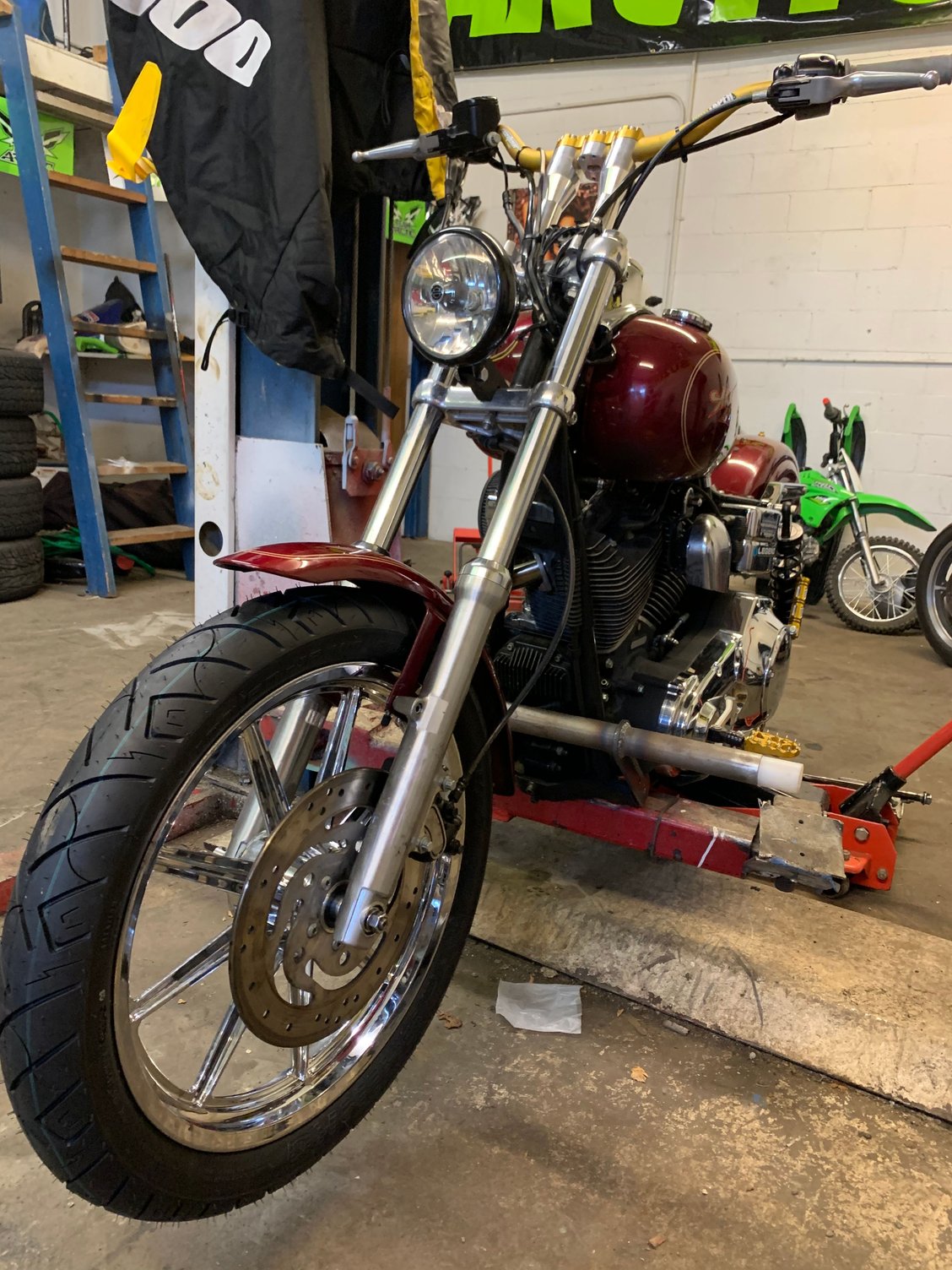

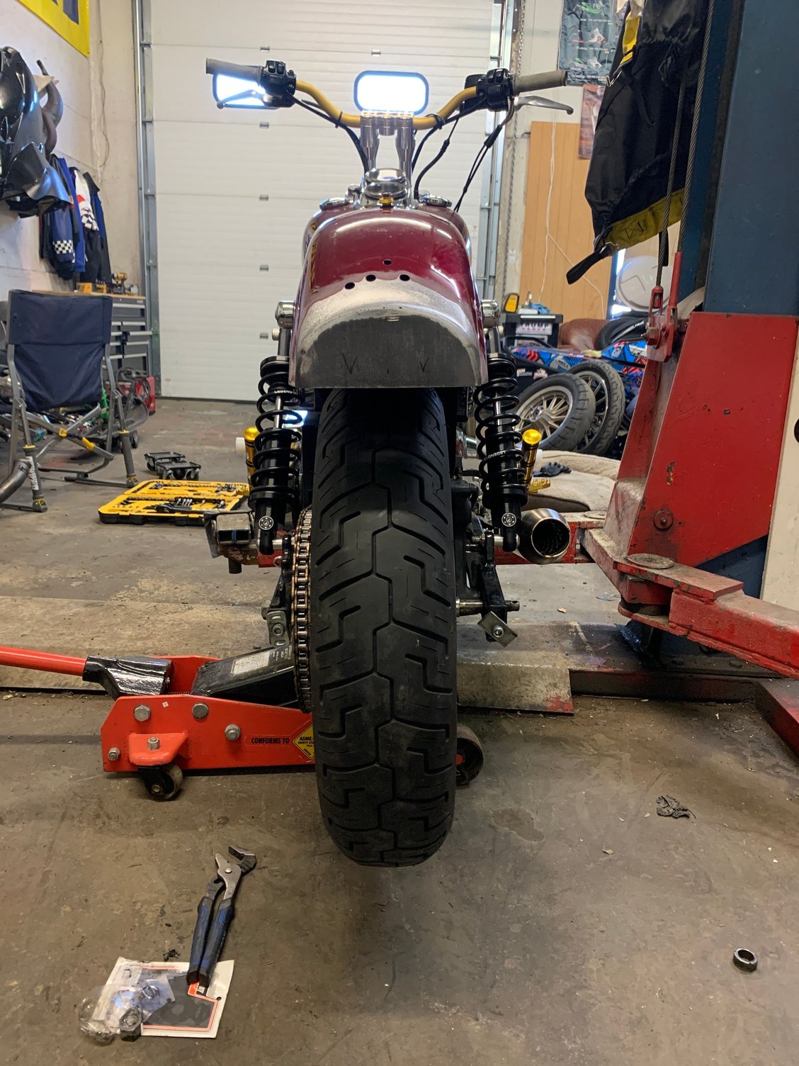

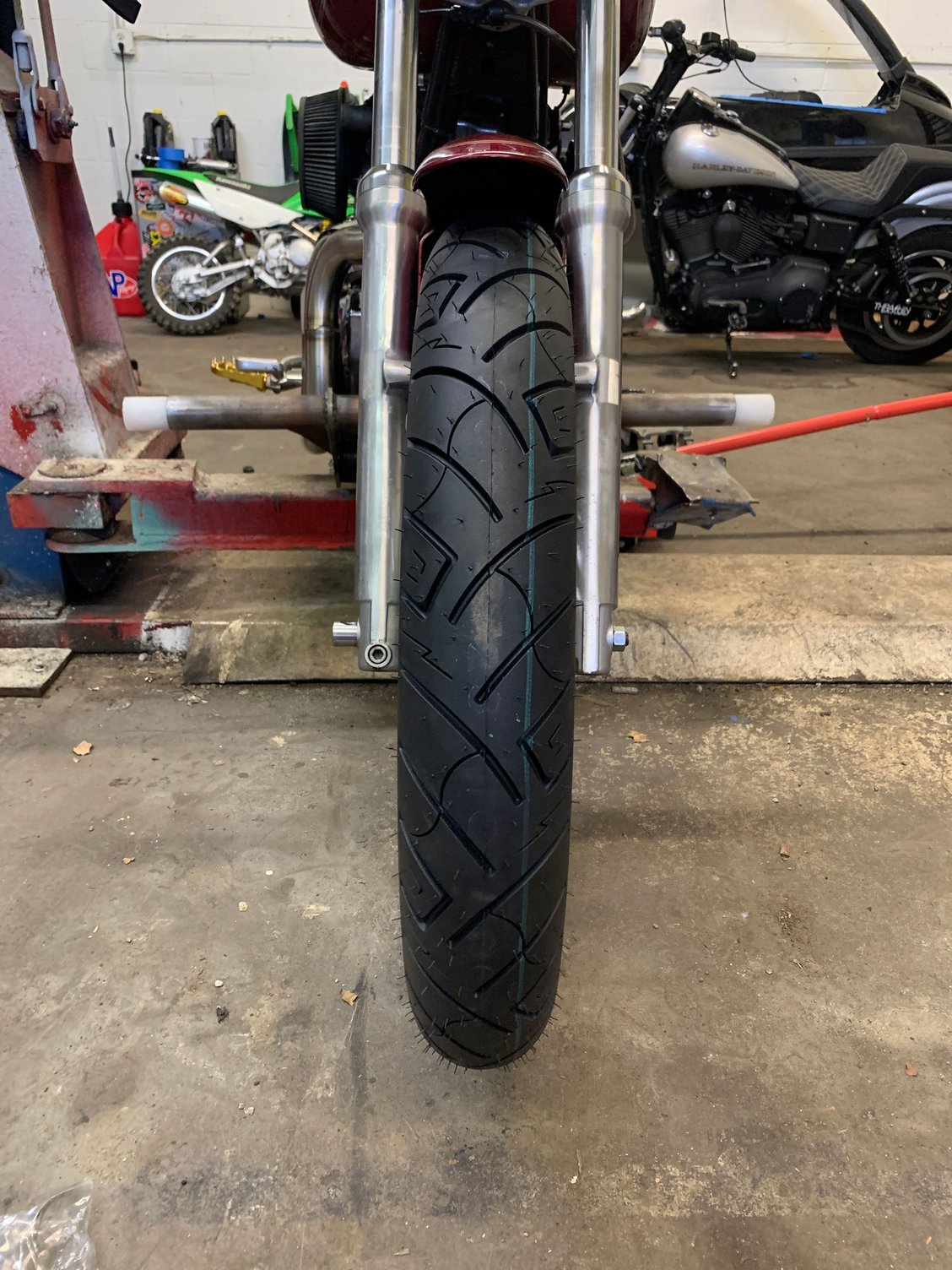

so here’s where i’m at. got everything back from harley, confirmed they set end play correctly. i got the front dead on using two rear spacers, but someone with more knowledge please let me know if you see anything wrong. as far as the rear goes, as there any official techniques to centering? kind of just going by eye playing with what spacers i have. i feel like i may need rotor/pulley spacers. again let me know if you see any issues or have any advice. thanks
