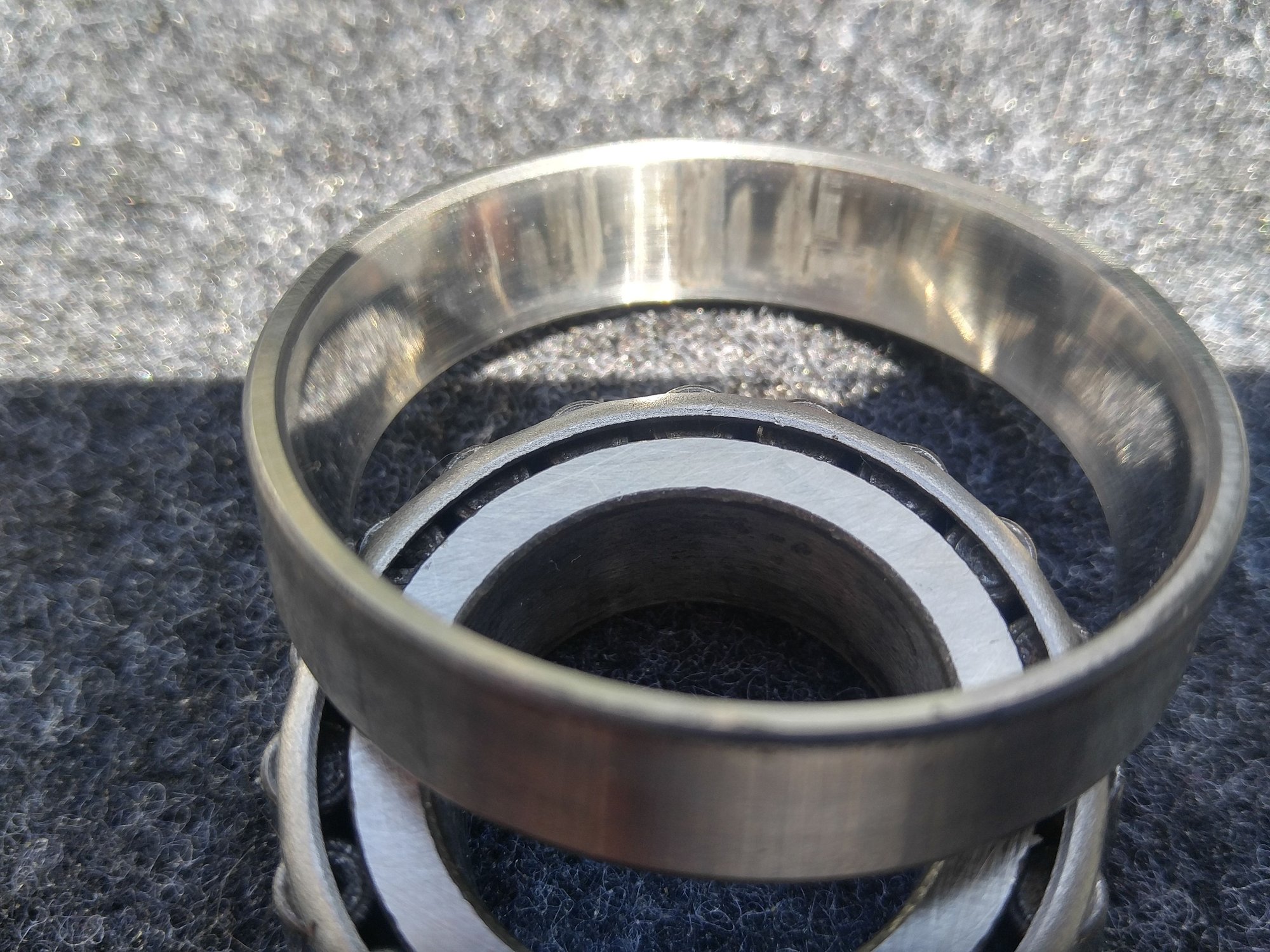

I pulled mine as a matter of course after a bad front end collision that bent the forks and rim but left the frame alright. They were 18 years old with 65k miles on them but were serviced twice in that time. Still looked fine after I cleaned them but the impact made me suspect them. Cost and effort to replace are minimal so it made sense to just do it.
Races were a little burnished but they rolled smooth as glass. I suspect the burnishing was from some miles spent out of adjustment (too loose and clunking when I bought it.)
