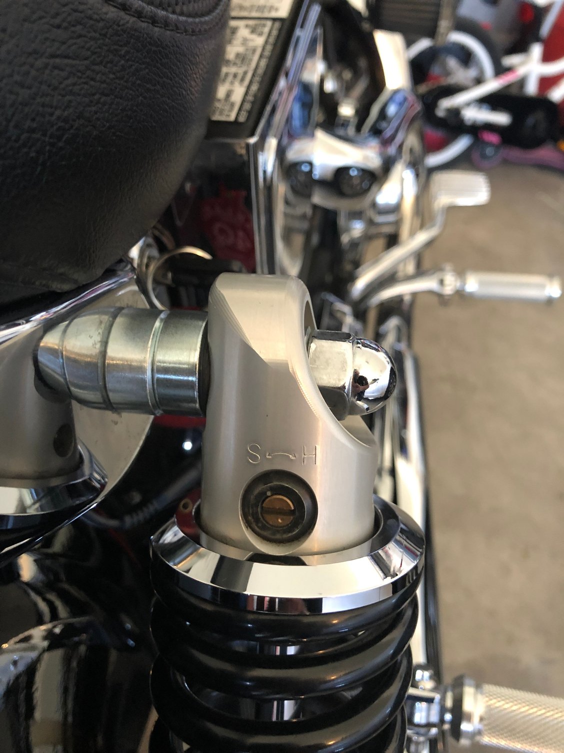

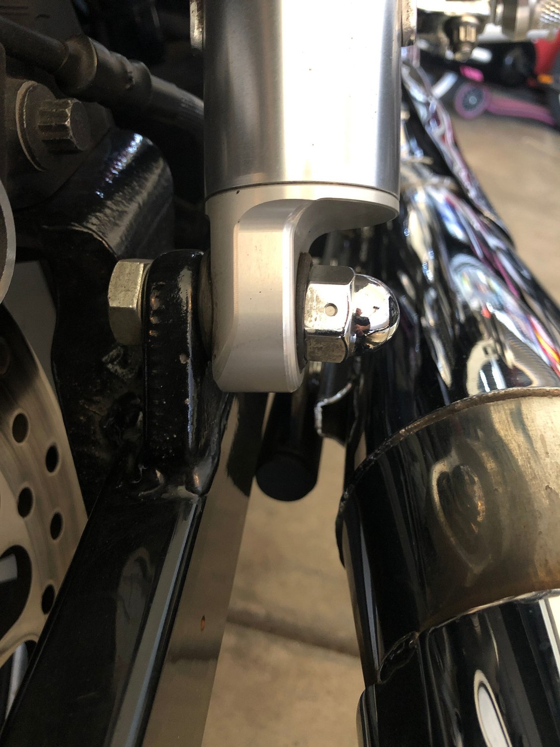

DX shocks are kinda unique on how they mount up, at least the hardware is. They’re narrower and take special studs up top and nuts and bolts on bottom. I run em on my low rider and just went to the hardware store with some measurements and used a socket head bolt about 4” up top with some shaft collars as spacer material. Below I used grade 8 bolts and chrome acorns top and bottom. Ideally if you had DX shocks you’d save trouble by getting the complete upper and lower hardware sets from the same model but good f’ing luck finding the collars up top.
